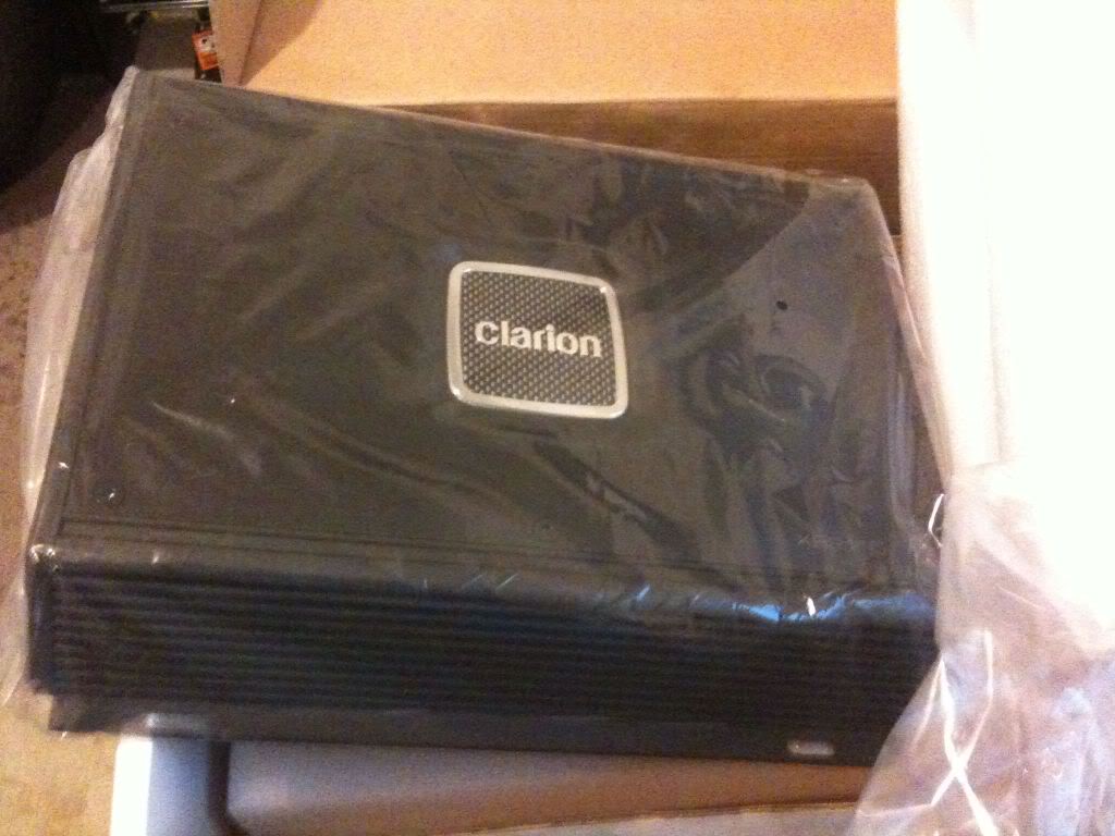

Amplifier and wiring kit came in the mail today so i installed it and my sub.

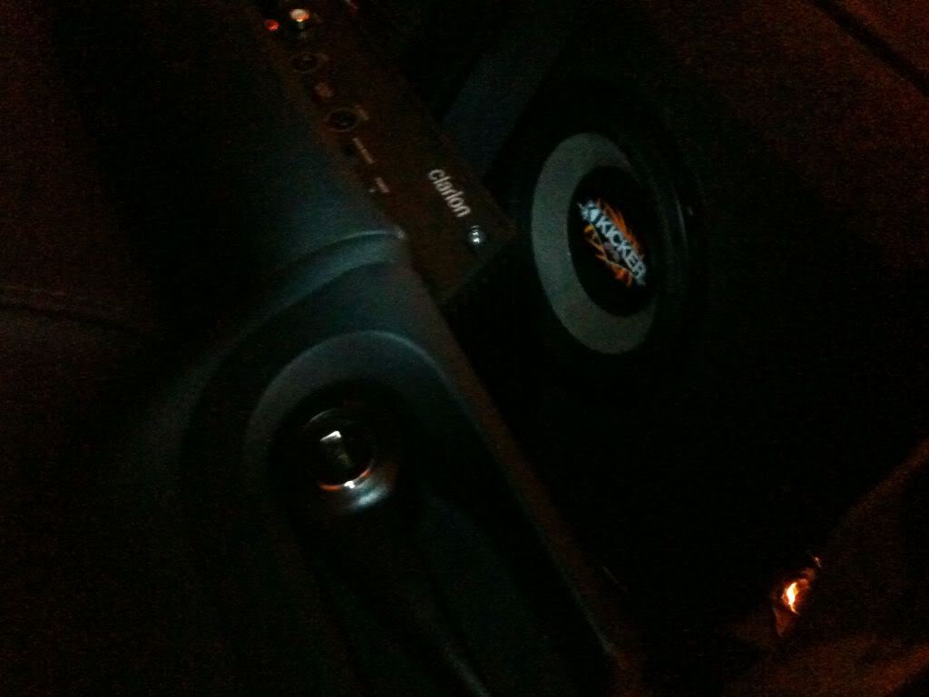

Amp is mounted on drivers back seat for easy access, still need to zip tie a couple wires to make it look neat.

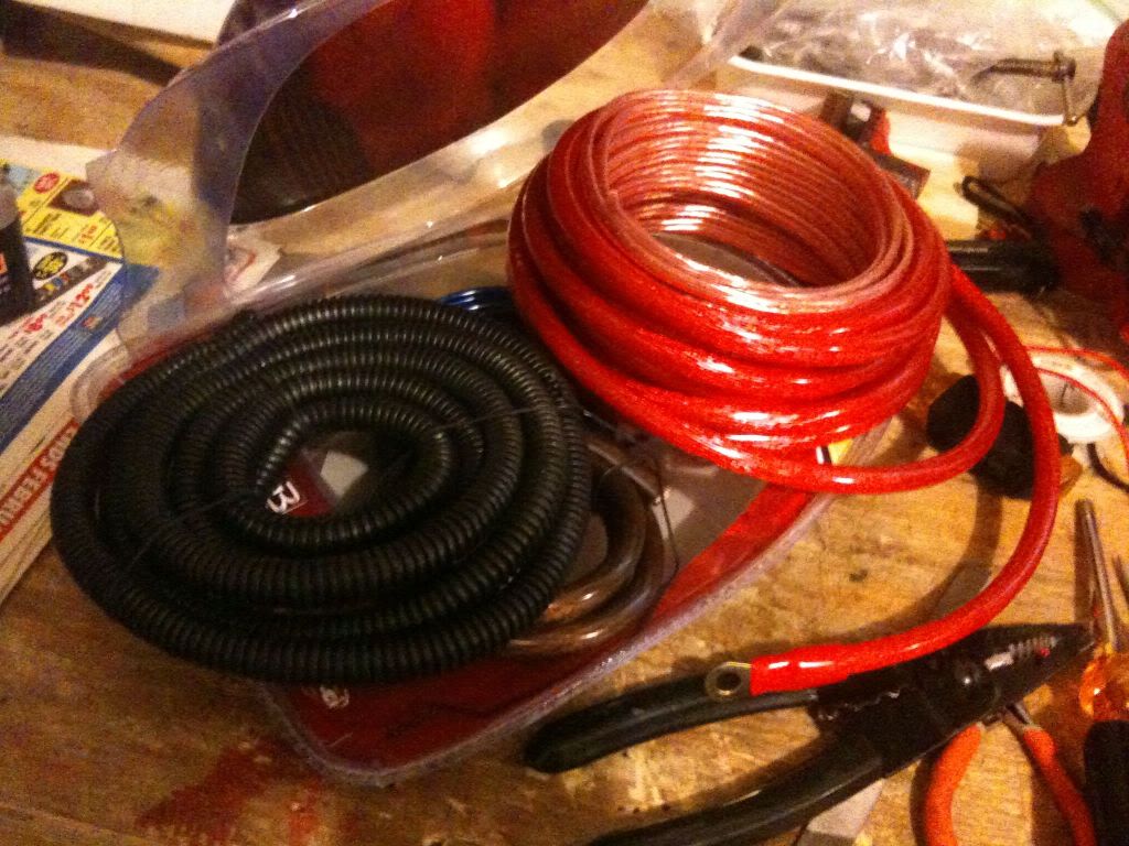

Ran power wire from battery through a rubber grommet by the ECU box, ran power wire down drivers side. I know to take our kickpanels off its a pain in the ***, but i managed to tuck a 4GA power wire underneath it without removal.

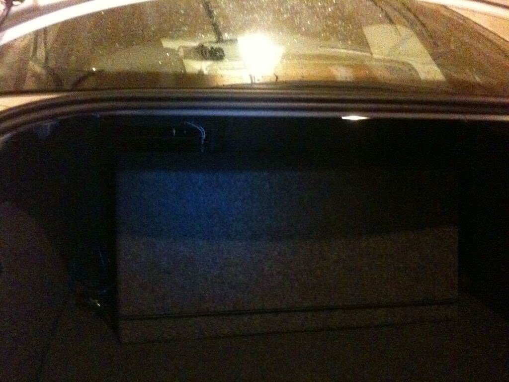

Sub is a 10" Kicker CVR in a ported box. My box is facing the backseats as in sedans with a closed of trunk, it will give you better results if you face it torwards the back seat. In SUV's or hatchbacks with the trunks open along with the cabin its better to face them backward or up.

Clarion XR2210 Amplifier
10" Kicker CVR in Ported Enclosure
DB Link PK4Z 4 Gauge Power Series Wiring Kit
4 Posi Wire-taps for tapping bose amp
16GA wire to extend tapped wires to speaker level input connects on amp
10GA wire running from amp to subwoofer

instead of using a bungee. get a roll of velcro. cut the side that is the rough part in half, tape it to itself and stick it between the box and carpet

That's a massive box for one 10". I should turn my sub around, that's a good idea.

Yeah it is. I got it from my uncle like 2 months ago after he took it out of his maxima, it isnt a custom box though, it came like that from kicker cause the box has their logo indented on it. Its the size of my 2 12" MTX's in my pathfinder.
