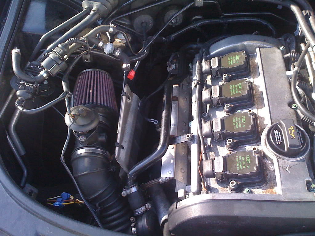

Old Dec 30, 2008 | 02:09 PM
Jc61990's Avatar
Posts: 3,326
From: Long Island, New York
yea i did put it back on. it came with 2 zip ties for you to use the original heat shield. thats how i have it for now until i get a better heat shield or find the time to make one
