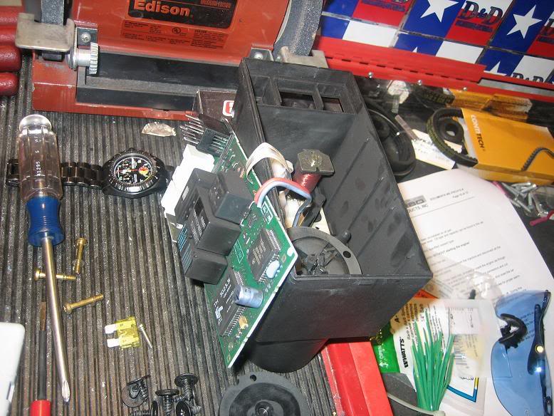

The whole door lock assembly (including the alarm electronics) is in one module in the trunk on the right side behind the carpet paneling and underneith a piece of foam. The box has vacuum lines and wires both coming out of it.
Looks like this. (when open)
Attachment 52615
I was wondering how you removed the box was their any bolts or just glued up? Thank you
There’s nothing holding it in. It’s just a module encased in foam, and all you have to do is squish the foam to remove the entire unit as one. There will be some cables and air hoses attached that you will need to remove, but that’s about it.
