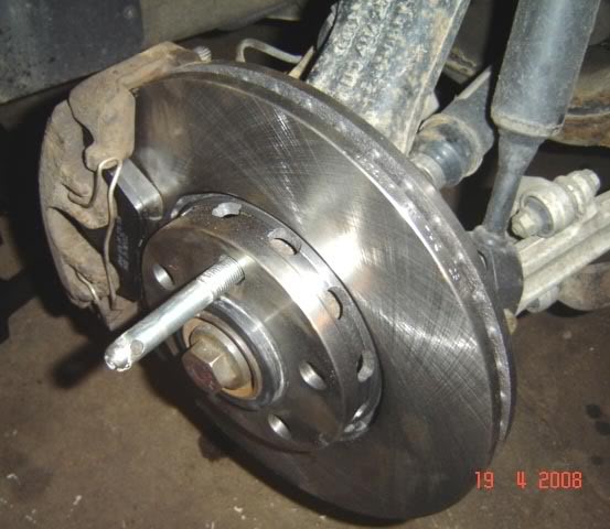

Why spend $16.95 for a line up pin? Go to the hardware and get a bolt the size of the wheel lug and cut off the head and drill a hole in it. Very simple and takes just a few minutes to do.
Good Luck...
