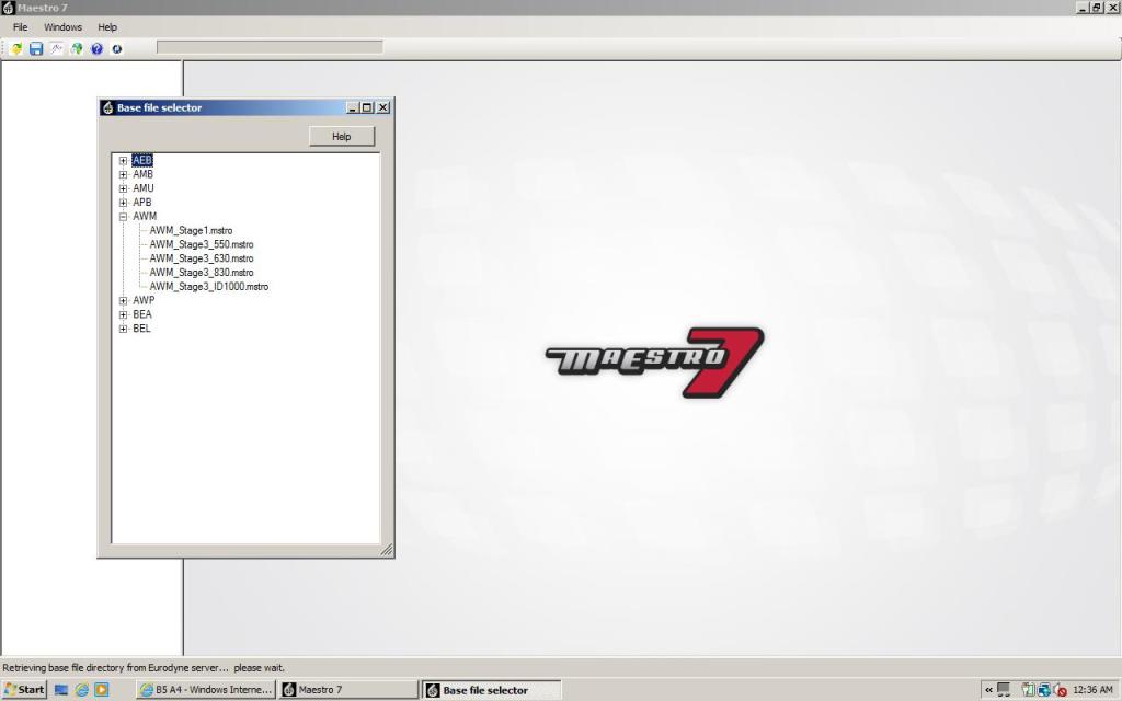

Thought maybe a few people would be inteested in seeing what maestro can do (for sure one person ) Well, it can do a lot. Sorry to say, but ive heard Maestro kinda sucks for AEB and ATW bosch motronic systems. so ill give what info i have on AWM systems, not to mention thats the one i run. it certainly gives a lot of flexibility on tuning options. first off the base files to choose from. to start, there are only a few AWM maps to choose from, one of which is the stage 1 file from eurodyne.

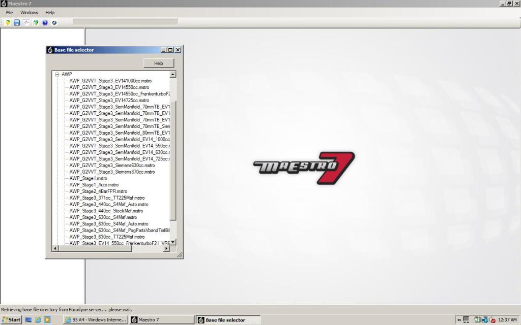

However, in CTapp informed me that AWM engines can use AWP maps, which are off audi tt's. these maps are quite numerous with this screen shot even missing a couple.

I would just like to start this thread on audiforums in case there is any interest with people wantin to go maestro. by no meansam i an expert, i hav simply purchased the program myself and am exploring i for what i can, but as far as im concerned, its as good as a stanalone system in many situations.
