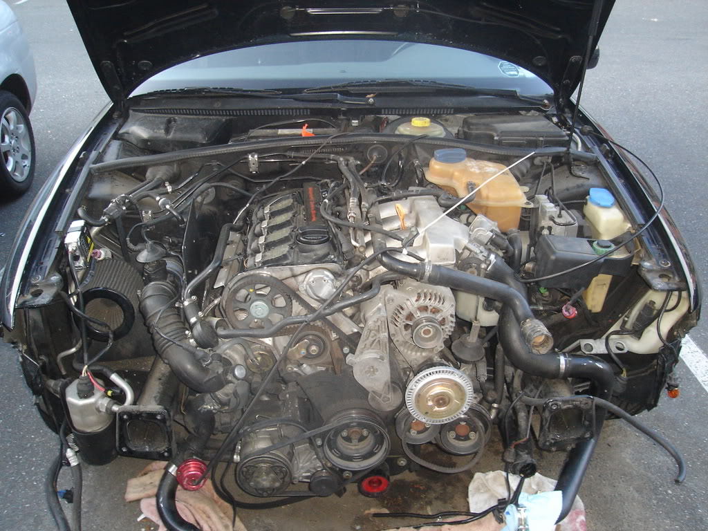

its in between the intake and TIP. should be sitting in the stock airbox at the top
you can see it in this pic. its in between the filter and the heatshield on the passenger side of the engine bay. you'll have the stock airbox instead but its still in the same location. has a electrical connection on the top of it
