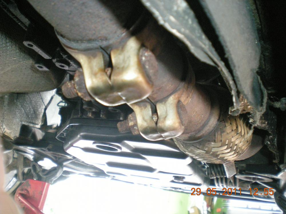

Today, I lifted the Car up for the First time and I saw the mini damage. After the Fire department Wash, I started the car today with no problems. That was good news.
Then I went to see the Damage under the Car and I did not like what I saw. Basically, From Cat Back was were the Smoldering had occured. All the Insulation behind the Shield had burned away. I think the Source of the ignition was Exahust pipe touching the shield. It had broken away from its place. And the Valve Cover Leak over the years had soaked the Fiber Glass behind it and dried up over the hears. Perfect Fuel Source. Carbon is a Good Fuel Source.
So I was you guys, I would go under the Car and make sure the Insulation is not touching the Pipe in any way. It should be at least 1" or 2 Away. And If You have any Oil Soaked Fiber Glass behind the Shield, it is a sitting fire waiting to happen.
I also believe that My Turbo is crapping out. I rev the Engine up and when I down Rev, I can hear slight rattleing coming from the Turbo. So, My Friends theory of the Turbo, Cat Fire is a good possibility now.
The Problem That I have now is that I can not replace that Shield myself and I don't have the tools, Time and Space for it. it wraps around the Transmission and part of Engine Compt. From the looks of it, Trans and Engine has to be dropped.
I just wonder how much all this will cost to fix. Dealer will kill me on this. I am looking @ $5000 Minimum. I also wonder if my Insurance will cover me on this a little. The Car is in Great Shape. I don't want to get rid of it yet. Any suggestions from you guys would be appriciated.
