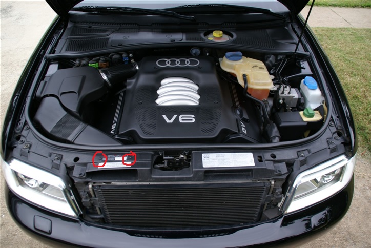

2. Remove the engine plastic cover using the screwdriver and strip off the weather stripping around the front.
3. Remove the 2 screws (circled in red) from the air intake. Remove air intake.

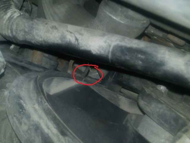

4. Remove the 1 philip screw using the stuby screwdriver on the electric fan. Careful not to strip it. There are some wires wedged into some channels of the fan. Pry them out so it gives out slack so you are able to move the fan away later.

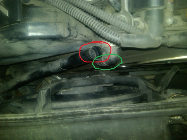

5. Now remove the hose, which i believe goes to the SAI. Wiggle the circle in red, down and away from the circle in green. Put it off to the side or use something to hold it away from where you want access.

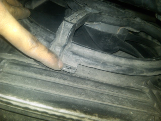

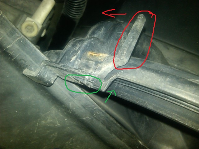

6. Back to the fan...There is this tab... Right at the very bottom...Circle in red. You have to pinch that. My arm managed to get far enough down there... You have to pinch it, WHILE you turn the fan counter-clockwise.
7. This picture is a close up of what you want it to do...When you pinch or move the tab to that direction, it brings up the little latch so it will free the fan and allowing it to rotate counter-clockwise.
8. Position the fan away from where you want access...You cant really disconnect it. There are cables that you just have to fiddle around to unclip from mounting clips allowing you to move it away.

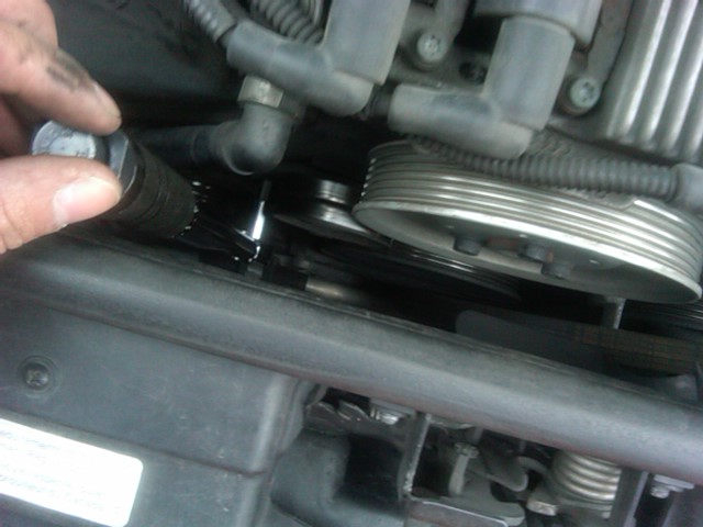

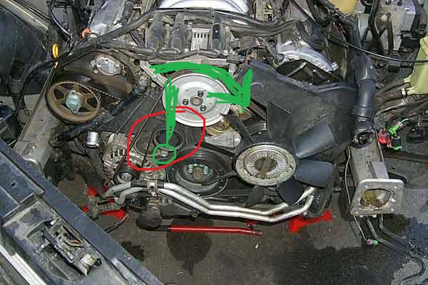

9. The red circled area is the tensioner. Place the 17mm socket wrench where circled in the green and turn as shown. This will relieve pressure permitting you to remove the serpentine belt. It is easier if you have someone holding the wrench while you remove the belt. (I didnt really took it out of the engine...I just put it aside. If you take it out, they say to mark it which direction so you can put it back to what it was)

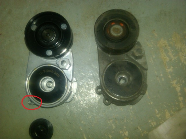

12. New and Old tensioner. On the new tensioner, there is a little pin that you have to remove (circled in red). Use a vice grip to squeeze the 2 holes together so you can push out the pin. BE CAREFUL when you remove the vice grip. When i removed mine, the tensioner snapped into place. I would have preferred that it didnt....
