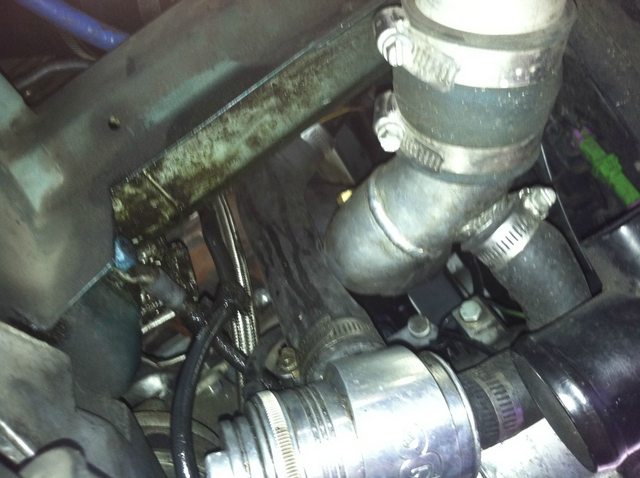

but how do you go you dv plumbled now? is it hooked up to the hot side or the cold side? if its on the hot side, i would recommend gettin it as close to the throttle body as possible. pics please

It is plumbed right into where my piping connects to the front mount, and then runs up back into the intake.
I was experiencing alot of engine knock last night and my vacuum was at around -17.
I loosened the spring almost all of the way, and my vacuum went up to -20 and im not experiencing any knock anymore.

looks like you got it plumbled right after the turbo. id move it right next to the throttle body if i were you. and run a blow off valve. but good to hear you got it fixed
