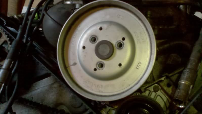

after taking ps pully bolts out how do you recommend getting the pully it self off?

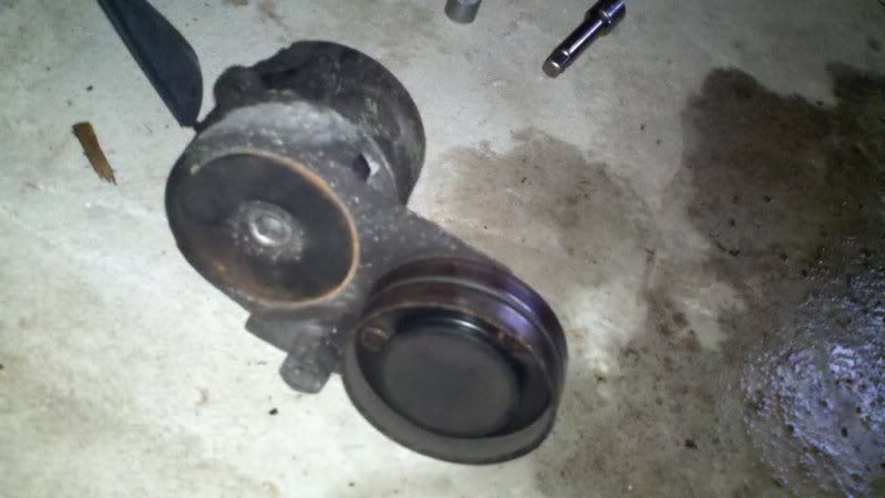

looking at the accesory belt tensioner should i change it out (unsure when it was last changed and cannot find in maintenance records. Is there a way to tell a dying one?)

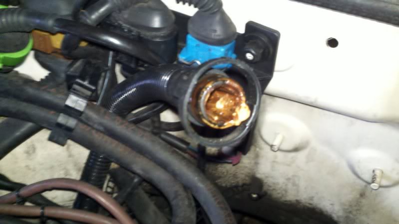

this is the nasty stuff im talking about. This is in the valve cover breather lines (cannot wait to see the nastiness in the valve covers)

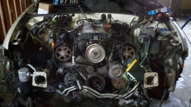

and this is how the car sits as of right now

To get that pulley off I took off the whole assembly, it was a tiny pita but I didnt see any other way. As far as that tensioner goes, spin that bearing and see how it sounds. Mine sounded like a bearing in an old skateboard, so I got a new one.

With the pulley thats strange i've seen people remove just the pulley i wonder why mines being so stubborn. I'm bringing my rubber mallet tomm so hopefully thats the trick.
That is the trick - just tap at it working your way around the face of it. Keep going around it and it'll loosen and come off. And no, that crap in your breather is not supposed to be there. As for the tensioner, it'd be hard to tell a bad one's spring tension from a good one without a good one on hand to compare it to.

damn, mine mustve just been stuck on there super good n tight. I stand corrected.
Yeah it can be stubborn and a pain but it'll come off. Spraying liquid wrench around the bolt holes and the back side of the pulley can help break up any gunk that is helping to bind it.
definetly suggest getting a new breather hose kit. i just changed mine and my large black valve was completly clogged and changing it all out made a huge difference. you can actually here the air go through the hose now. the kit from ecs sucks. i would suggest getting the kit from blauparts.com
