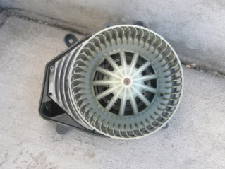

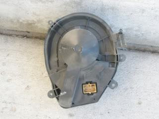

When the fan is not blowing, does the auto function on the climate control cause the fan speed to go up and down like its lost? That could be something else with the climate control system.
If the fan quit working and the climate control isn't searching for the blower motor, it is most likely the fan speed relay that is attached to the fan assembly. It is the finned portion of the blower assembly. Or the motor itself has gone bad. See pics below.
I have more info for you, coming up.
