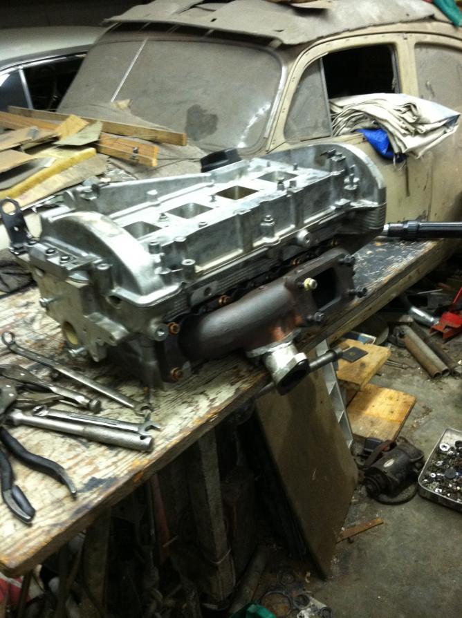

There's a picture of my rebuilt head ready to be installed.
well i was in the market for a new head as the one on the motor i bought was crap. i ended up buying a aeb head thats at the machine shop now. i am looking for an awm valve cover and cam sprocket though.
