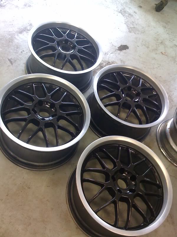

Well I bought this set of rims of Sykoro pretty cheap cuz they needed some work. A good bit of elbow grease and here are some results! I used 2 coats of Rustoleum automotive primer and 3 coats of Rustoleum Hammered finish. It's not too normal but it looks pretty damn good imo.

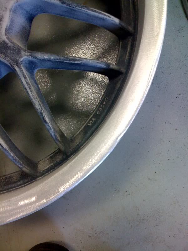

This is after I took the grinder to sort of repair the curb rash. It's nearly unnoticeable once there's a tire on.

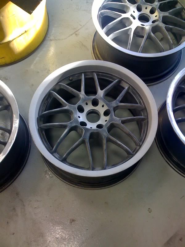

All of them sandblasted

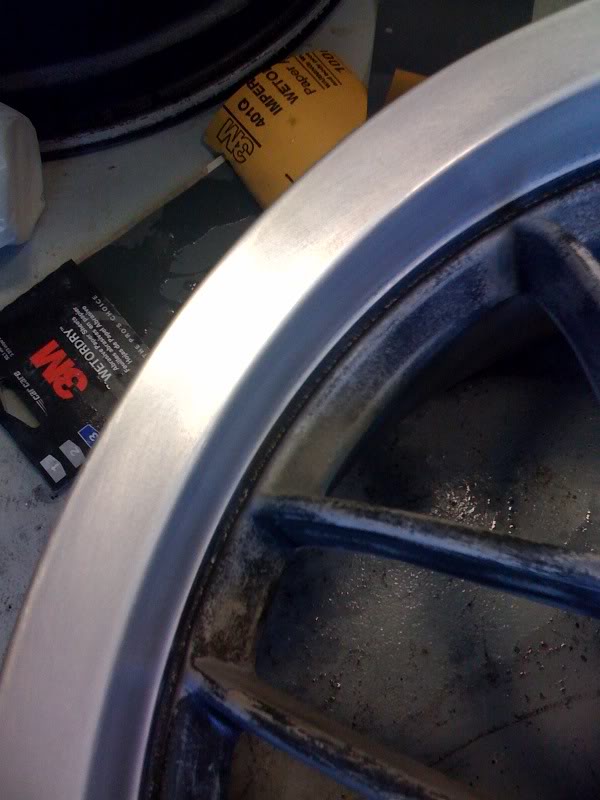

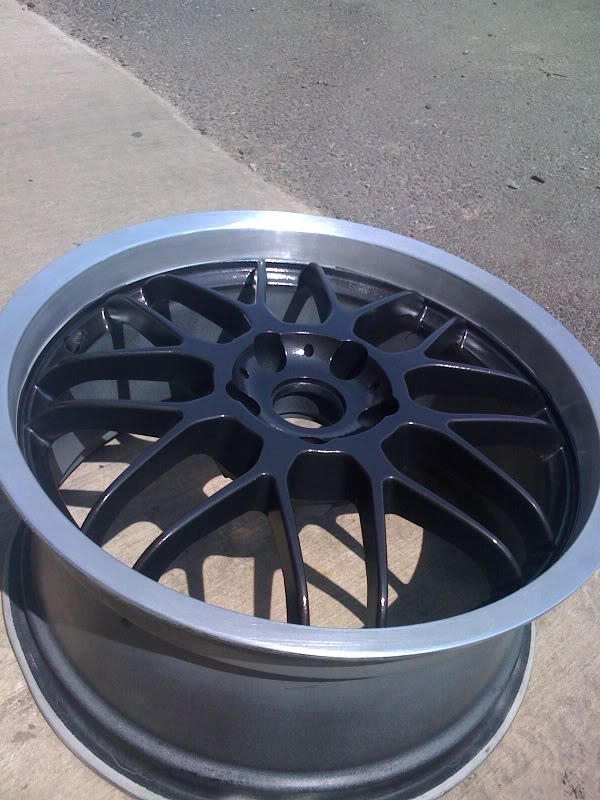

Showing the finish I chose for the lip. I decided to go for brushed instead of a polished lip. It looks pretty neat but I may eventually polish it.

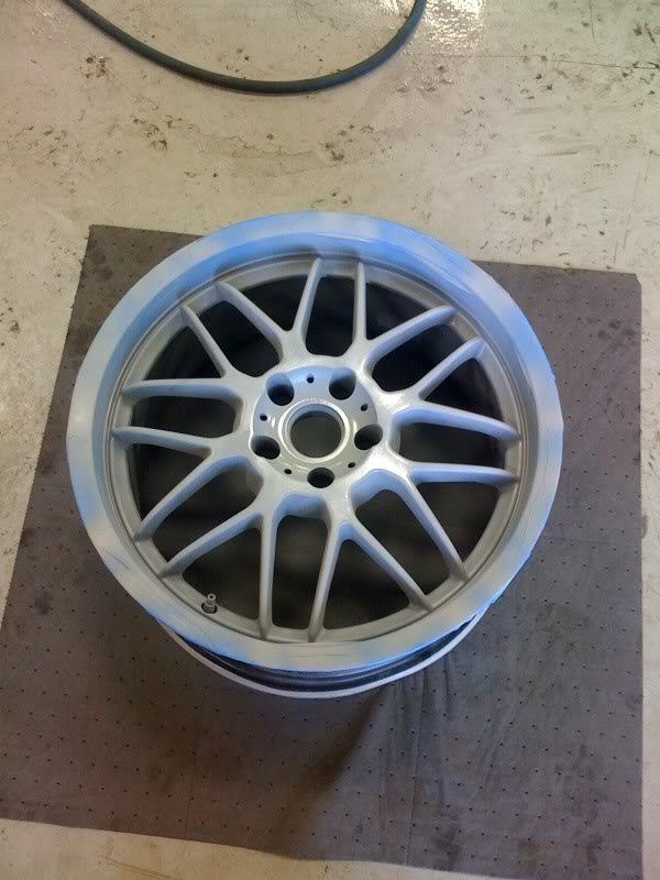

Taped off and primed

Yay all done!

A shot in the sun.

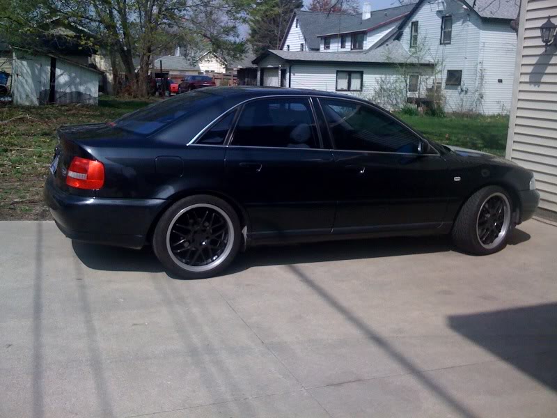

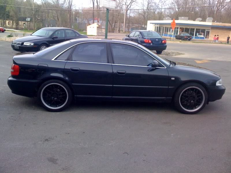

And we're off!

that came out very well! i would definitely go with the polished lip, though. make it match the chrome window trim

Looks great. Well done.

clean, very nice job!
wish you were lower!

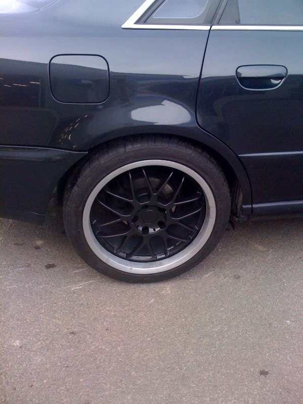

Worst part is the car is lowered... lol...
New picture of it looking sexy in the sun!

awesome job on the wheels man.. looks great.. i think the polished lip would work a little better might stand out a little more.. but awesome job

i used 1000 and 2000 grit on mine and that turned out really nice also i used NEVR-DULL which made it look almost chrome. I would say if you havent used 1000 and 2000 grit and use NEVR-DULL you would see a big difference. Good luck
