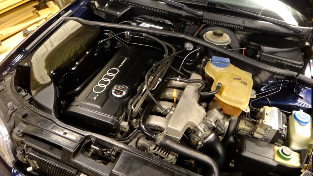

So I've got a few updates.
It turns out my right rear wheel bearing needs to be replaced as I thought. Either this week or next week I'll be pulling the rear spindles out and having my shop press in some new bearings.
I removed my S4 front sway bar and replaced it with the stock A4 bar and I've been happy with the results so far. The car doesn't want to oversteer as bad as before, I'll need a few more months to make a final conclusion though. Speaking of changing back to old parts, I think I'll remove my N75J and put the stock one back in and compare results.
I finally finished getting my carbonio intake mounted so I'm no longer embarrassed to post pictures (it was just zip tied in place earlier.)

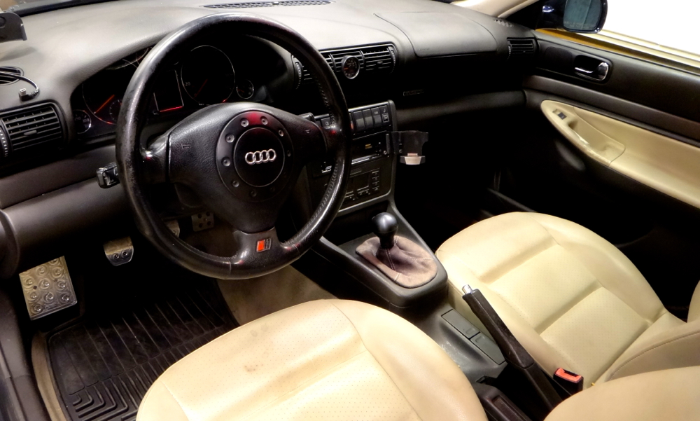

I'm long overdue to take a bunch of new high quality photos, but these will have to suffice for now.

Thanks guys, I just looked at my old interior pictures, things have changed a little bit!
I've been putting in a ton of hours on the car recently, mostly cosmetic engine work.
After taking off the false firewall hood seals I cleaned and waxed all the exposed paint in the engine bay. Today I removed the turbo inlet/outlet, intercooler, and throttle body hoses and gave them all a good cleaning.
There was a decent amount of oil in the pipes (I'm pretty sure they had never been cleaned though) and a few sand sized pieces of metal.
I checked the turbo for shaft play and there is maybe 1mm, not too bad. The little metal pieces in the hoses has me a little worried though. Compressor blades all looked perfect..
This all started from wanting to replace my N75J valve with the OEM one to do some comparison. So far the OEM valve feels just slightly smoother, I think I like the J valve better... a little more fun.

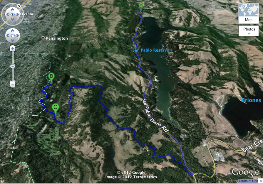

This 11 mile road is a 10 minute drive away from my house and provides for a good test circuit. The first dark blue half has a nice mixture of short straightaways and tight corners, good to keep you on your toes and test the tires. The second half is quite a bit faster.
San Pablo Dam Rd to Shasta Rd & E Wildcat Canyon Rd, Berkeley, CA 94708 - Google Maps
