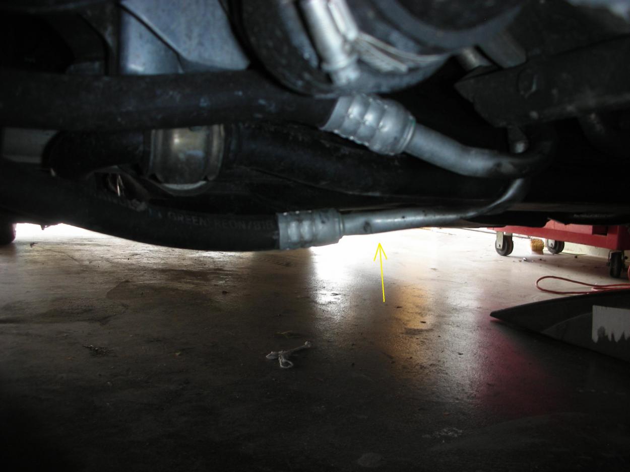

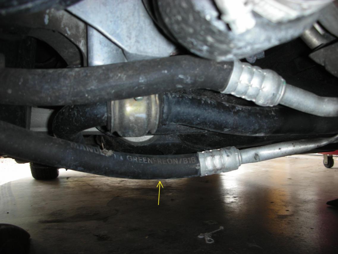

Anyone know what this hose is called or what it connects to. Also if anyone is parting out a car and has this send me a pm.

couldnt tell you for sure but looks to me like a power steering hose. either that or a a/c line.

looks like the power steering hose...be careful the metal pipe that connects to that hose looks damaged so get it checked out.

notice it says 'freon' on it and connects to the a/c condensor, that is the a/c line. if you leave it broken for too long and get moisture in there you could be replacing your entire a/c system so get it fixed or atleast sealed up asap.

**** it has been broken for about 4 months but didnt think anything of it cause it was cold outside. So should I just replace it and hope nothing else is wrong?
