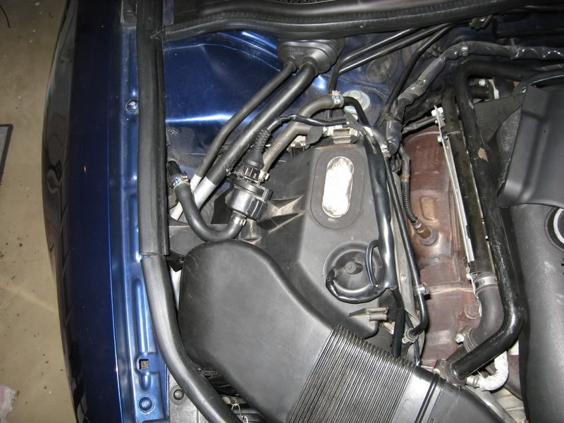

ok so this has been a pain the past couple days.. i did the airbox mod and my check engine light came on as a result.. went to my audi tech (at and audi dealership so he is legit) and he said i am pulling TOO much air in.. so i put the airbox back to stock and after a few the check engine light is still on even after a few errands and turning the car on and off and letting it cool
SO.. i have prob taken apart my airbox and put it back together like 6 times now and the last time i made sure it was good and tight and all the hoses are hooked up...
went for test drive.. started to bog down in first i got to where i would usually have to shift just before 7rpm's and it was at like 5 check engine light blinking at me.. i shifted through 2 to 4th and the car became stable and check engine went back to just on and not blinking..
so i opened the hood and heard an electrical tick tick tick... and it was coming from this..
just so you know where i am in the engine..

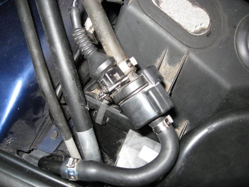

and the piece
is this a sensor? im assuming it is and it is making an electrical tick... could this be the reason my car is bogging down? or are there other problems do you think?

I forget what its called, but it's supposed to tick and is unrelated to your problem.
As for the blinking CEL, that means a misfire. You might have killed your MAF by manhandling the air box. Get your ecu scanned for fault codes and post them.
