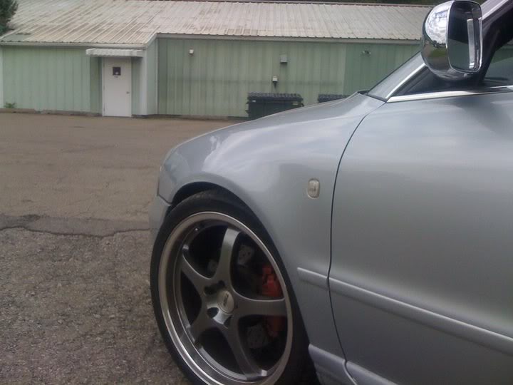

I had 19x8 with 235-35-19, ET37, with a 2.5" drop. My fenders got raped every time the suspension compressed. A 225-section tire probably would've just barely for into a rolled fender. As it sat, I could get my pinky into the gap just to the base of the nail.
Old Feb 19, 2013 | 11:39 AM
ImTheDevil's Avatar
Joined: Jul 2006
Posts: 11,670
From: Binghamton, NY
This is how it sat:

This is how it sat:
damn! yeah well i was only going to go probably with a 1.5 drop but you think 19s would still rub?
Old Feb 19, 2013 | 04:00 PM
ImTheDevil's Avatar
Joined: Jul 2006
Posts: 11,670
A 1.5" drop with 225s should be fine. Use a 19x8 wheel with around ET38 or so and you should be fine.
