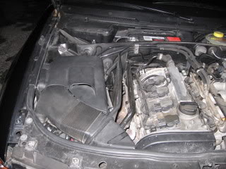

where is the spark plugs at?

under the 4 pushdowns(coil packs)

yeah. its a 5mm allen head. two per coil pack. its a 5/8 spark plug socket i think. I would just use the NGK iridium that comes in the car. and i dont see it necessary to unplug the coil packs. just the little ribbed tabs holding down the wires.
