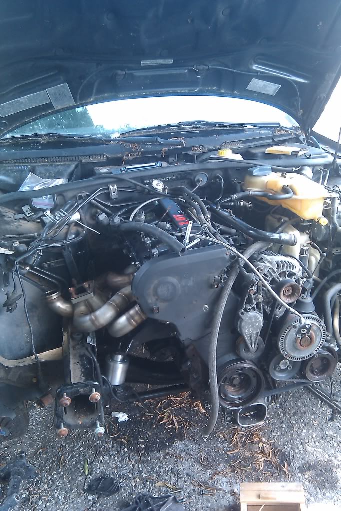

here is a pic and its the belt on the right which would be drivers side. It is the belt that goes around the power steering and the water pump. My question is can you take off or loosen the water pump pulley without taking apart the front end?

Here's a pic of my car with your engine with the ac removed. As you can see it was on its own belt. So which belt are you talking about.

Ok no you'll need to take off the front clip. That belt tensions by putting the 2piece pulley back together and tightening it up.
