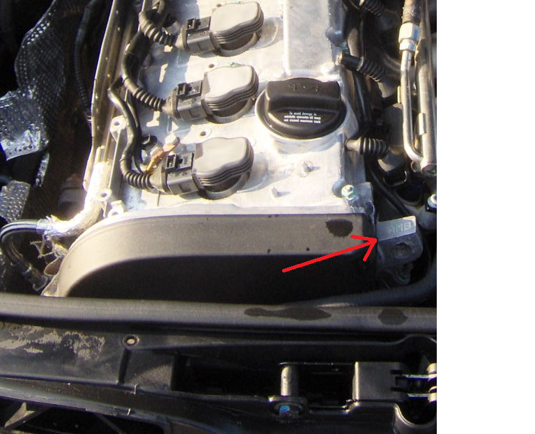

Also I forgot to ask, how do I know wich tooth timing belt to purchase?. They are showing two.
What engine code?

Where would I find the engine code you are asking for?.

The engine code should be on a tab near the timing belt cover it will a flat machined piece off the head on the driver side front. Should read AEB AWM or ATW.
Also.. You really shouldn't get the engine bay wet with a hose chances are you got the coil packs wet and they are causing misfires. IT should clear up after a few days/heat cycles.

Have not orderd one yet just saw online that there was two different tooth numbers. Jason i am haveing a tough time finding that plate, it could be because i am looking in the wrong area. Do i need to remove the timming belt cover? thanks again.
This picture should help.
You may need to remove the plastic engine cover to see this.
Jason

Foud it it AEB engine, so what tooth belt do I need?. Also It seems like I am going through a court of oil every two weeks. Its not leaking or smokeing, it's not in my air filter, where els should I look?. Thanks for your asistance.
