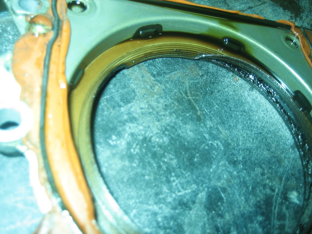

We bought the car which had a new (OEM, LuK; receipts) clutch installed (including new rear main).
With less than 8000 miles on it, it started slipping. The shop who installed it refused to take a look, just quoted a new clutch (drivers fault).
We bought a new South Bend Clutch SB Clutch Kit: OFE Stage 3 (rated at 300+ lbxft torque) from Deutsche Teile Haus and had it installed by our local transmission shop. I was present when we took the old one out. The clutch was not worn (just a little glazed), but we found that the rear main seal was installed wrong (lip folded over), likely allowing oil to get into the clutch.

Did you replace the trans input shaft seal? You have to replace the release bearing guide tube to replace the trans output shaft seal, considering the are combined into one unit. I went through the same ordeal, the previous owner had replaced his clutch twice before i bought the car. Either that or you could be running into an issue with a bad pressure plate or flywheel.

3000 miles on the Southbend. We installed the Southbend after the new factory clutch installed by the previoius owner failed after 8000 miles (and found the wrong installed seal (see above ficture) and assume all was good.
