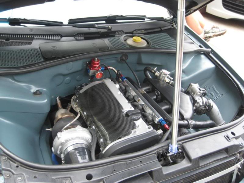

Originally Posted by CCA4
How extensive is the shave/tuck going to be? Can't wait to see more progress!
Have you seen A4Rob's? That extensive. EVERYTHING will be hidden. you'll see a motor and a ginormous turbo. thats it.
like this:
I, however, will be leaving my hood strut on the car so the mount for that on the driver side strut tower will be staying. The ABS will be relocated to the battery tray, and I will probably be using a smaller braille-style battery
