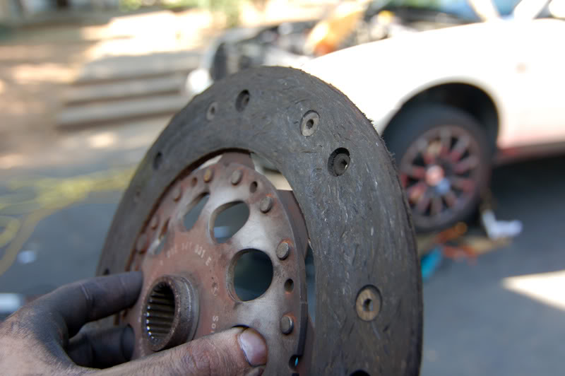

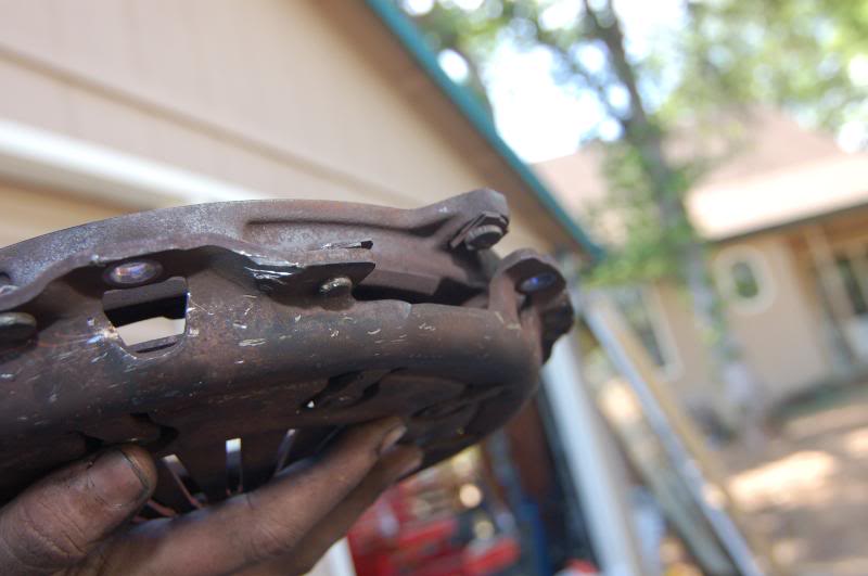

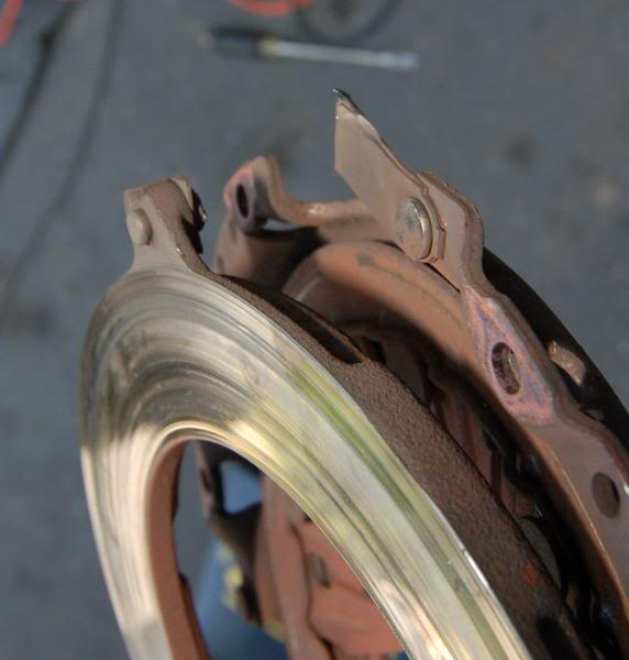

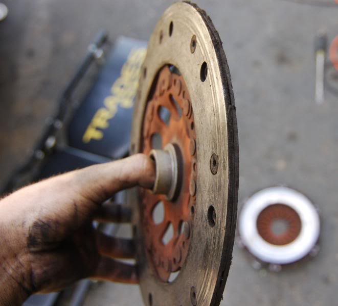

This is what happens when you launch on the stock clutch....
once the clutch is replaced, you should really upgrade all of the driveline mounts before any aggressive launching.
And if your friend launched your car, that's why your clutch is slipping. have fun installing the new one. Get it from mike, he's a good guy.
