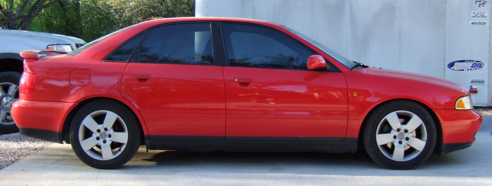

I get 24 5/8" fromt ground to top of wheel opening in front and 25 5/8" on the rear.
Attached Thumbnails Newbie w/ ride height question-dscf0882.jpg

Looking at the picture, I can say right off the bat that the suspension isn't stock (nor sport) as it sits pretty low. If you look at the shock or spring, it should probably say what brand they are.
The spoiler does not necessarily come with the sport package as they are optional from the dealership.
And the seller was correct. Those are the C5 A6 wheels.
