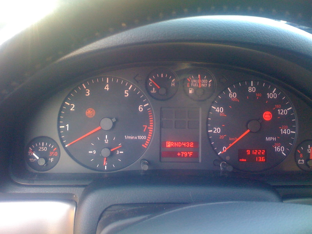

CEL is check engine light
it will always show if the car is not started, start the car see if its still there, if it is go to auto zone to get the code read
