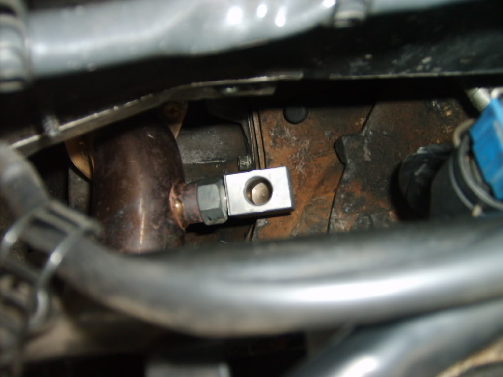

nope from the top. look towards the back of the block and look down and slightly towards the passenger side.
coming off the passenger side of the block is the turbo, behind that is the cat, and the post o2 sensor is the second o2 sensor on the cat. the pre-cat o2 should be real close to the turbo, the post-cat o2 is closer to the exhaust.
here's the best pic i have of it. its with a test pipe and angle block so yours if gona look different, but it should still be in the same location. this is looking straight down at the back of the block
