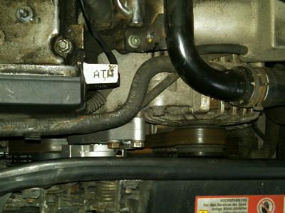

can you tell the engine code from the VIN of the car?
WAUDC68D41A117575 is the vin off my car.
Old Apr 8, 2013 | 06:06 PM
  #15
hartsoe1's Avatar
Joined: Jan 2007
Posts: 460
From: western NJ
Open the hood and look at the top of the motor up front.
Attached Thumbnails Oil Pan Removal and pump/screen Replacement-atw.jpg

The engine is an AWM.

If it's an '01 it's an AWM. The fastest and easiest way to tell is by the accessory belts, if there's a v-belt it's an ATW or AEB, if not it's an AWM.
