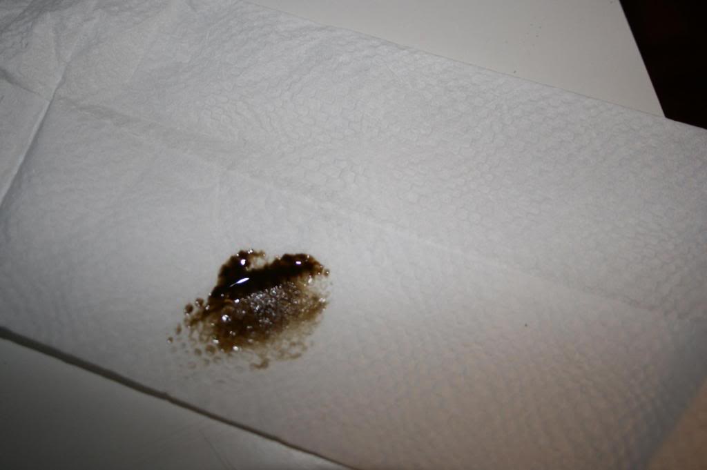

see photos
sludge on my finger
this is in a grey plastic sack. the camera flash makes it look slightly lighter in color than it looked in person in my dark garage
this is what it looks like on a paper towel
see photos
sludge on my finger
Probably the head gasket. They are normally never an issue with 1.8Ts, but at that mileage and seeing those pics idk... Oil coolers are cheap though. Start with replacing it and doing a GOOD coolant flush. Use whatever coolant you want as long as it's one type and not a mixture of oem g12 and universal green stuff. Oil cooler is simple. Take the oil filter off, remove two hoses and take it out by removing the center nut and watch out for the seal.

the sludge in there is a light brown really thick crap.
