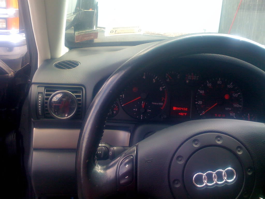

i tapped into spot 1 on my car, just so i dont have long cables everywhere, and my gauge sits in my drivers side vent. i got power from the dial lights

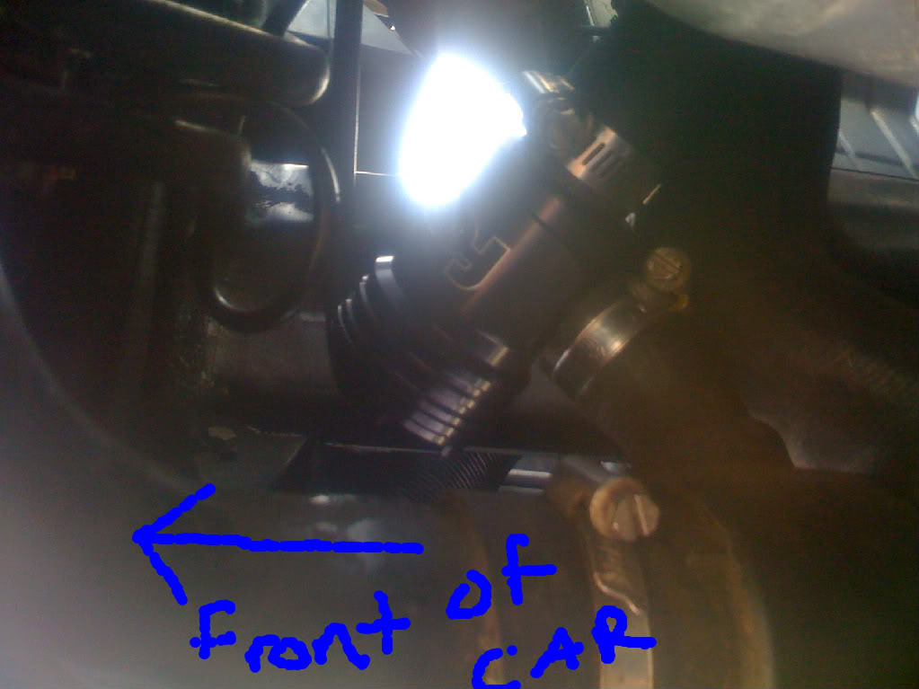

jack the car up take off the skid plate and you will see one of these
pull it out and put the new one in, its way easier than the 97....
should look something like this

and if your looking down into the engine... its looks like this... circled
