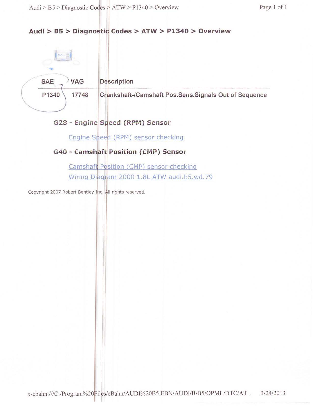

I'm chasing a P1340, which is either the Engine Speed Sensor or the Cam Position Sensor, per Bentley. (By the way, the car runs great even when throwing the code) I have easily checked for resistance and voltage at the sensor plugs, which all check out (I have cleared the code). The next steps involve the Audi "test box" which mentions checking connector pins back to sockets 82, 90, 108 for 1.5 ohms max. I never hear about anyone using this test box, so are the pins at the ECU harness marked with numbers corresponding to the Sockets? Thus I can check continuity without the test box? Thanks

TBelt and all related work was done by me within the last 25k miles. I've attached the Bentley page mentioning the two sensors as the cause for p1340. If there is more practical, real world info out there, please continue to suggest. I've ordered both sensors from ECS and they were only about $30 each. The car has 191,000 miles so I'm not buying top end sensors.
