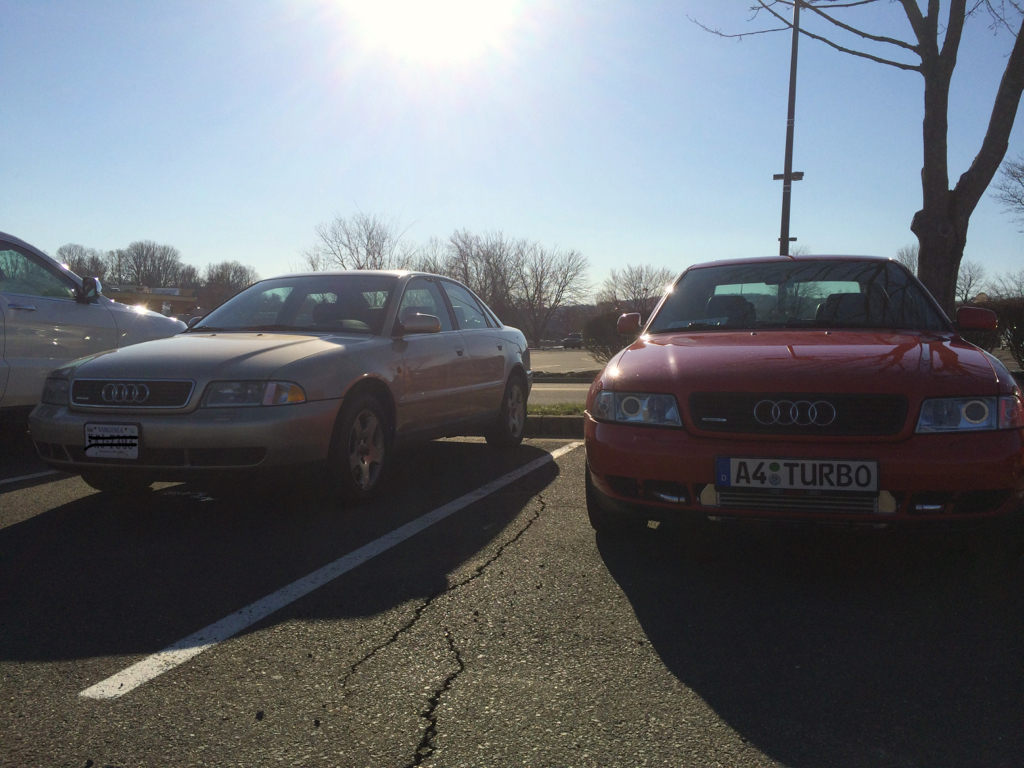

A friend from work just bought a stock 98.5 (same year as mine) 2.8 manual/Quattro. Reppin' the rings
