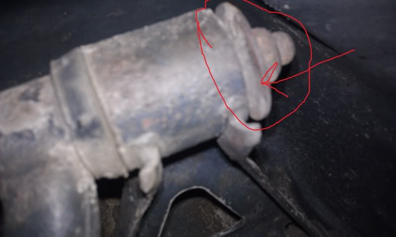

While I was in there last night, I noticed the upper control arm (?) looked like it may have a shot bushing (or missing one) on the rear pass side.
Never really dealt with control arms before, so I'm not sure if I'm heading in the right direction with this?
Thanks for the help.

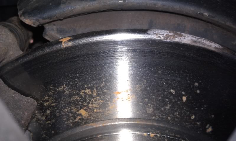

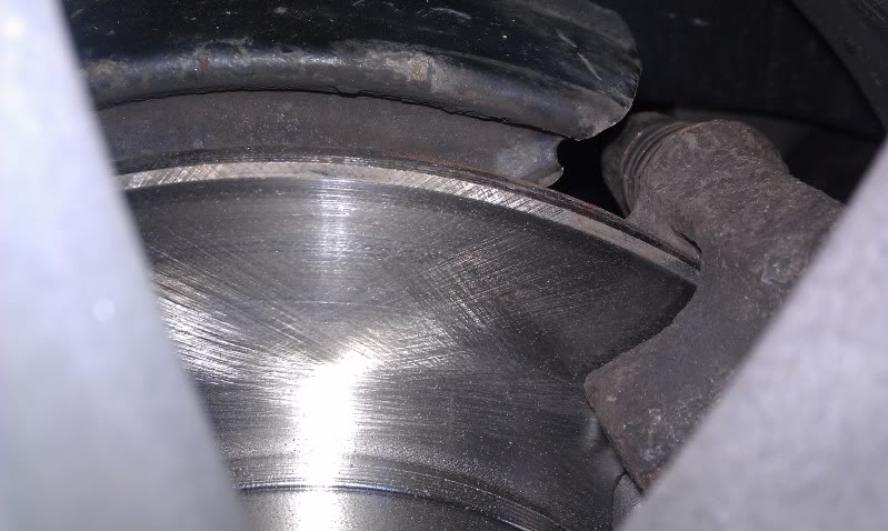

So the new calipers arrived, will be installing them tonight. Like I said before, I already installed pads/rotors on the rear, have only put about 60 miles on them, and this is what they look like now:
drivers side
passenger side (one with the problem, i believe)
Would a stuck caliper cause the rust/ugliness on the rotor?
