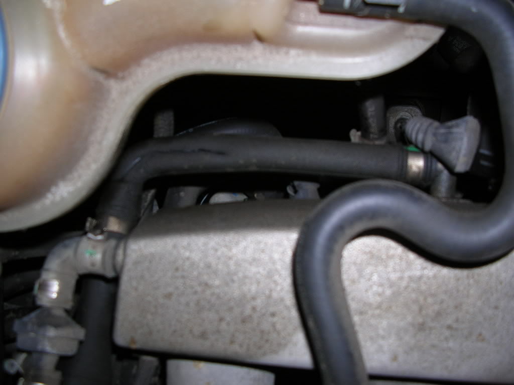

What is this line?

(the fubar one)

Just an L shaped breather hose. ECS tuning sells it.

Yeah, got it. Just needed to make sure it wasn't vital before the car was driven (not mine).
Thanks... PN 06B-133-783-BC for search purposes.

There will be some boost lost with it torn like that when the manifold is under pressure, but no big deal to drive around with it like that. Engine will run a little rich, but hardly.

all the L shaped hoses rip in almost the same exact spot
