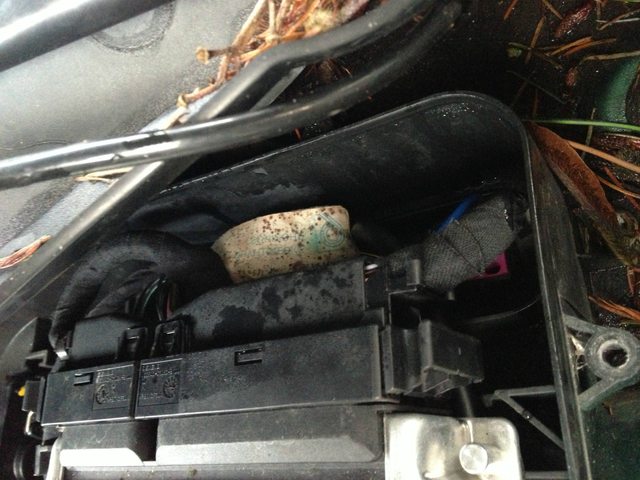

When i got into the ecu box, this is what i found.
Quite a bit of moisture and water.
I'm starting to consider that it could possibly be the ecu.

I also dried out the ecu. The light still came back for the sensor.

When you say you "dried out the ECU" what exactly did you do? If it were me I would open the metal casing, make sure it is bone dry, then clean anything that looks corroded with contact cleaner including anything internal and any external connections..
