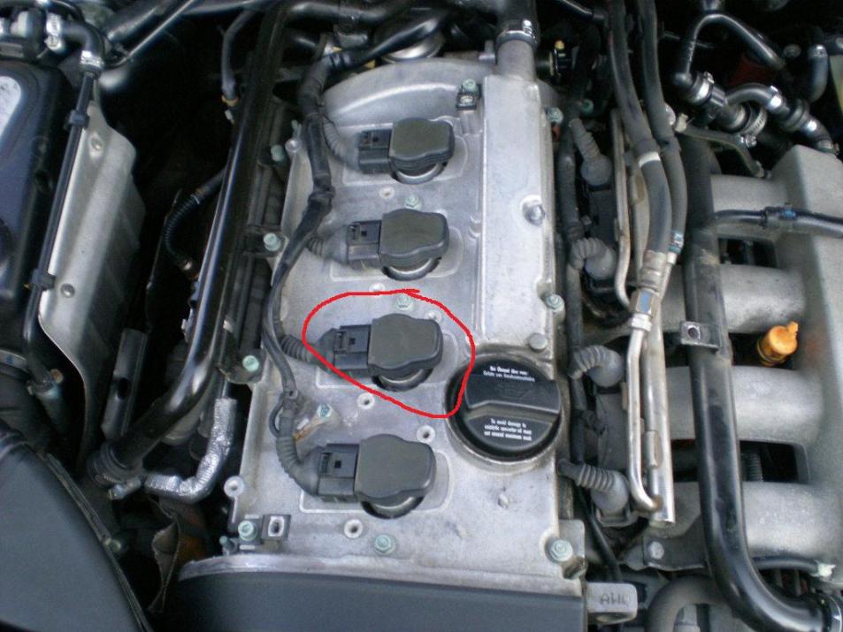

no lights came on but this is the plug that was popped up

it's possible that the scews came loose maybe

Yeh...thats not normal. Each coil pack has two screws in them on mine. Are they missing? Maybe different on the 01? You would def misfire if it was popped up
