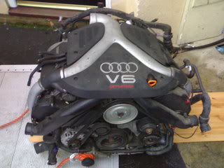

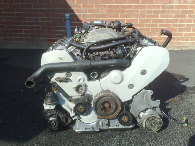

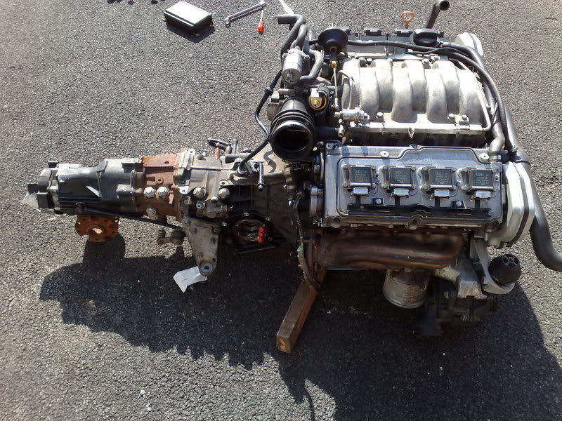

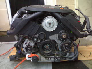

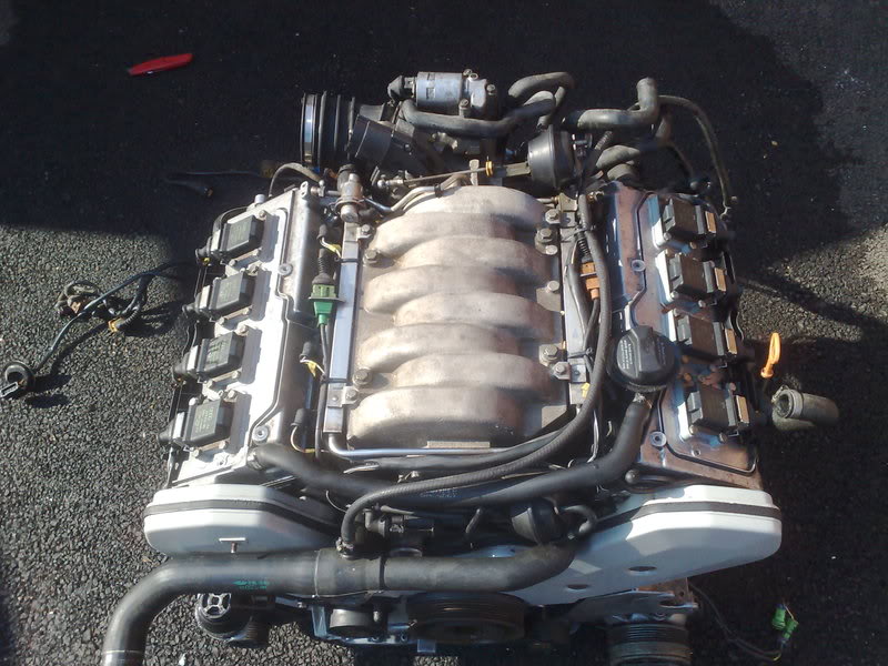

Engine originally destined for Project B5 RS4 Sedan...
Recently sold to make way for S8 power...
Note large throttle body - no problems getting air in there when I later go forced induction...

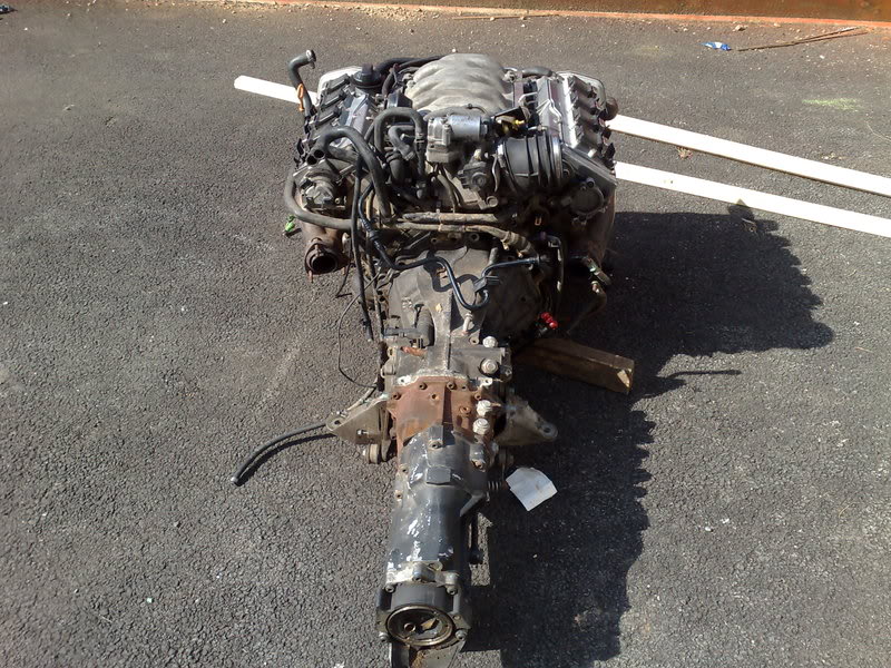

Rebuilt 2000 S4 6-speed tranny. I also bought a 6-speed from a wrecked Allroad 2,5TDI, and robbed it of the 5th and 6th gears, to replace the 5th and 6thin my S4 box.
Now geared to do 37.5mph per 1,000rpm...

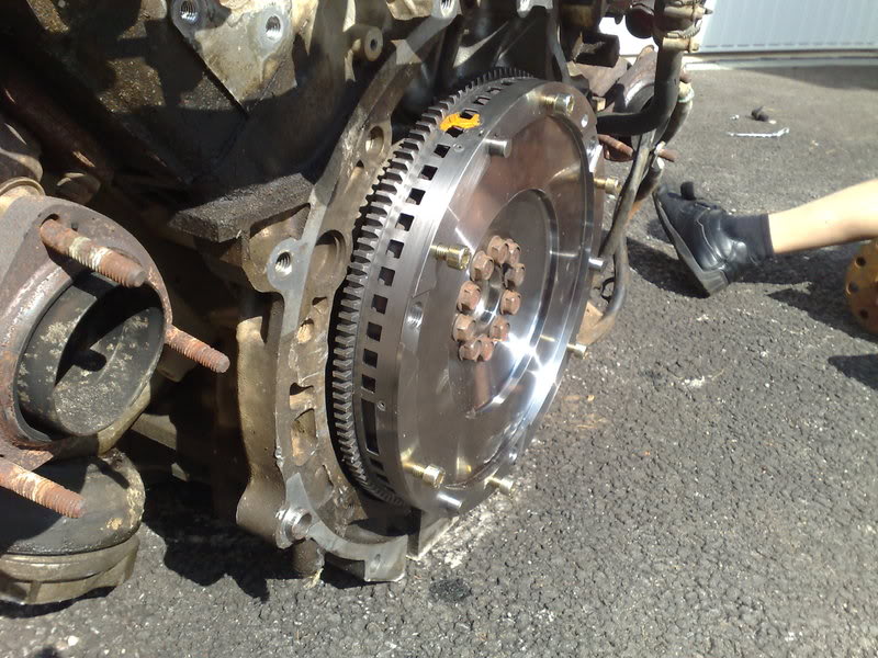

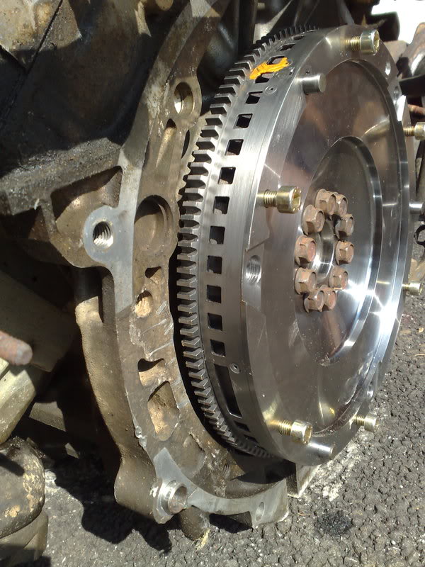

Manual V8-engined Audi's were never imported to the UK.
So, I had to have a flywheel custom made...

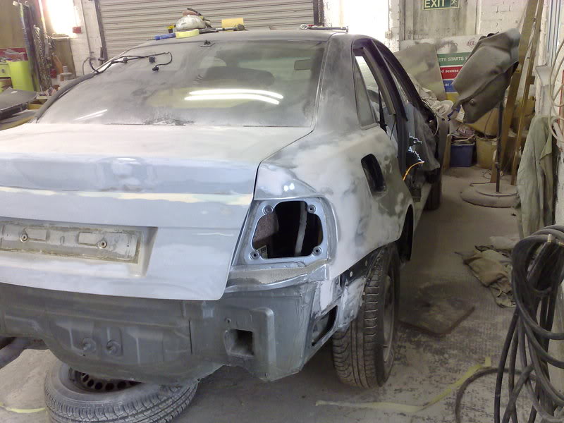

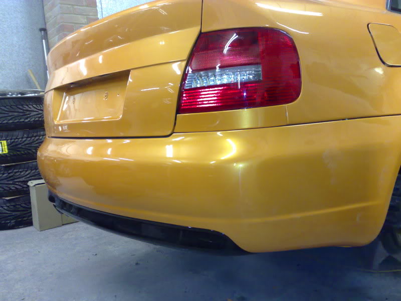

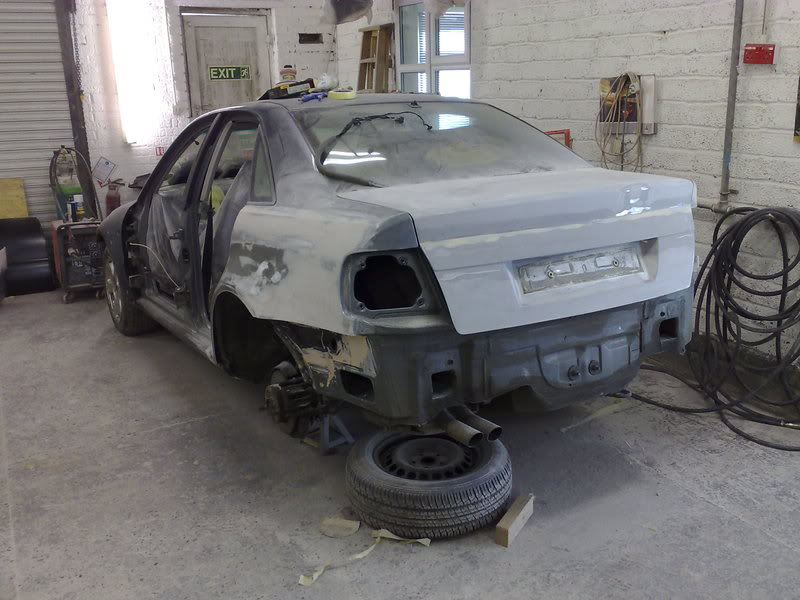

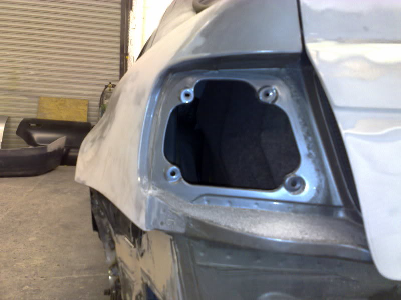

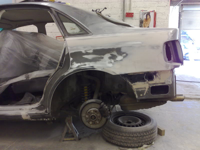

My car went into the bodyshop on the 17th November 2007, and was ready for collection on the 29th January 2008.
My B5 sliced open, all her tired old bones showing...
More pictures...

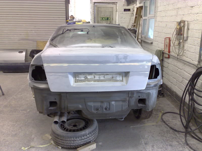

Old Jun 29, 2008 | 07:56 AM
  #15
Siena's Avatar
Joined: Mar 2008
Posts: 235
From: Suffolk Coastal, UK.
Default RE: Project B5 RS4 Sedan.

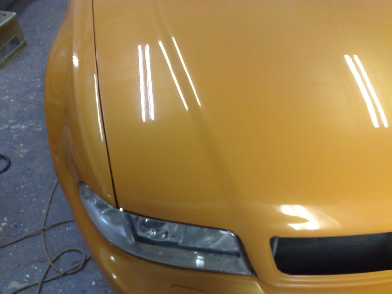

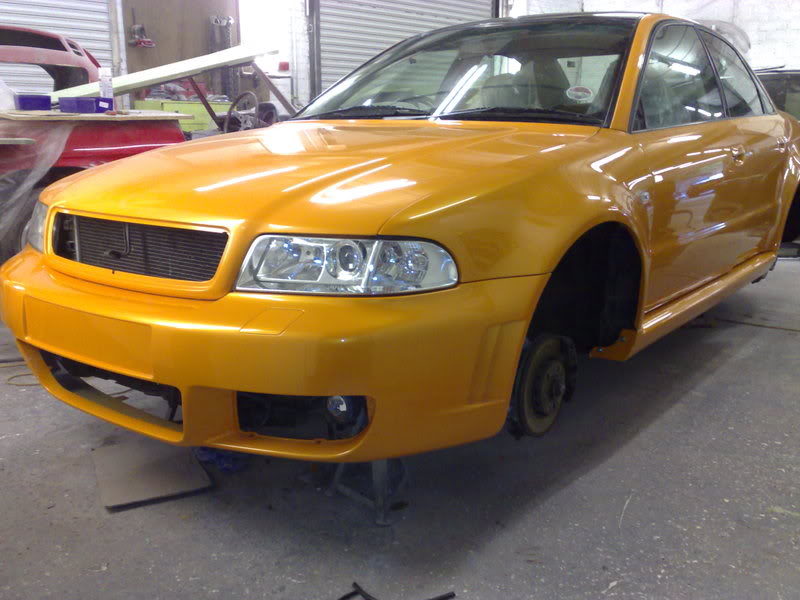

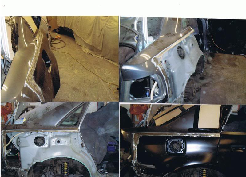

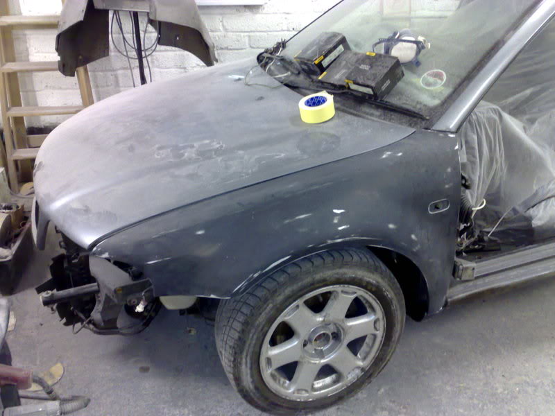

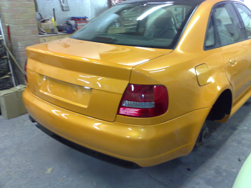

She began to look less like a wrecker sometime early January...

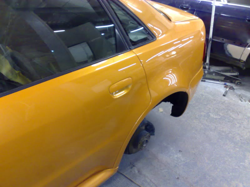

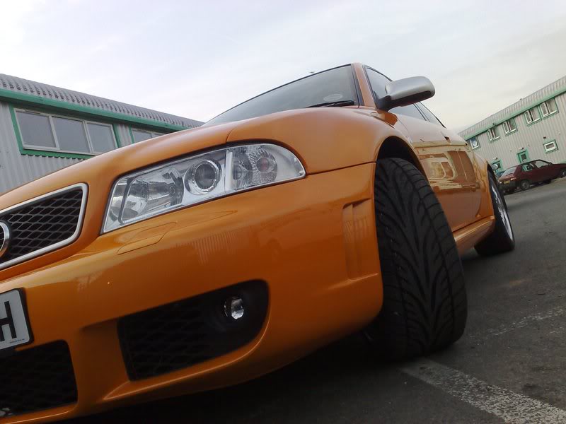

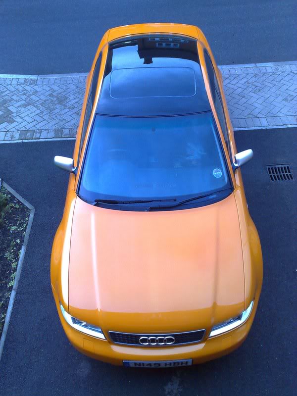

At last, she's done, and back home where she belongs...

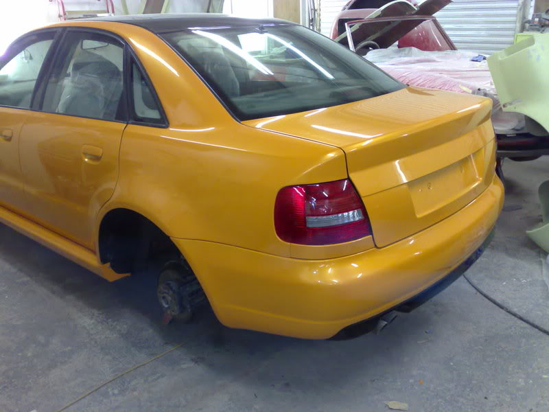

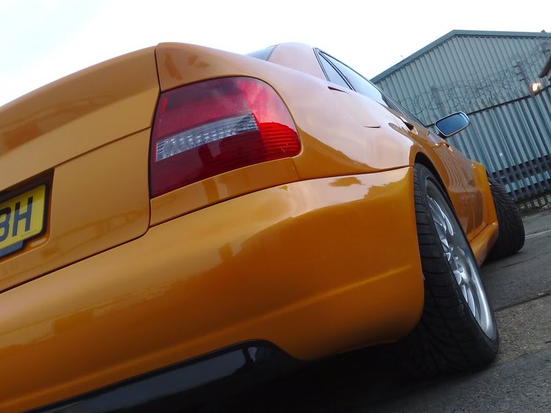

Old Jun 29, 2008 | 08:15 AM
  #17
Siena's Avatar
Joined: Mar 2008
Posts: 235

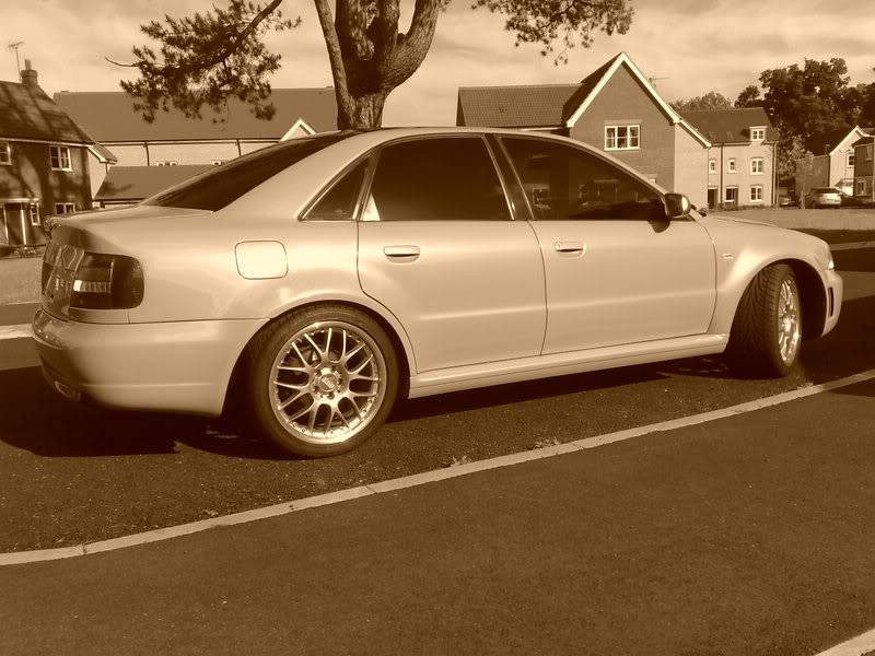

And some in Sepia. Note the suspension has settled a fair bit lower...

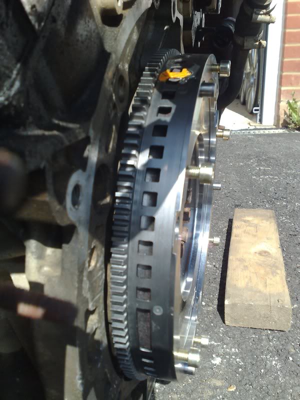

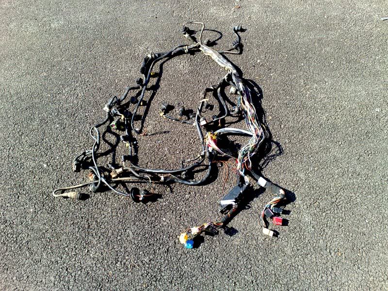

Removed the wiring harness, ready for modification. Includes removal of the auto box ECU / connector, replacement of the main ECU connector with the VEMS one...[/align][/align]Name:  14062008648.jpg
Size:  222.8 KB[/align][/align]Flywheel fitted to S8 motor...
[/align]Name:  14062008644.jpg

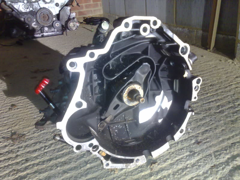

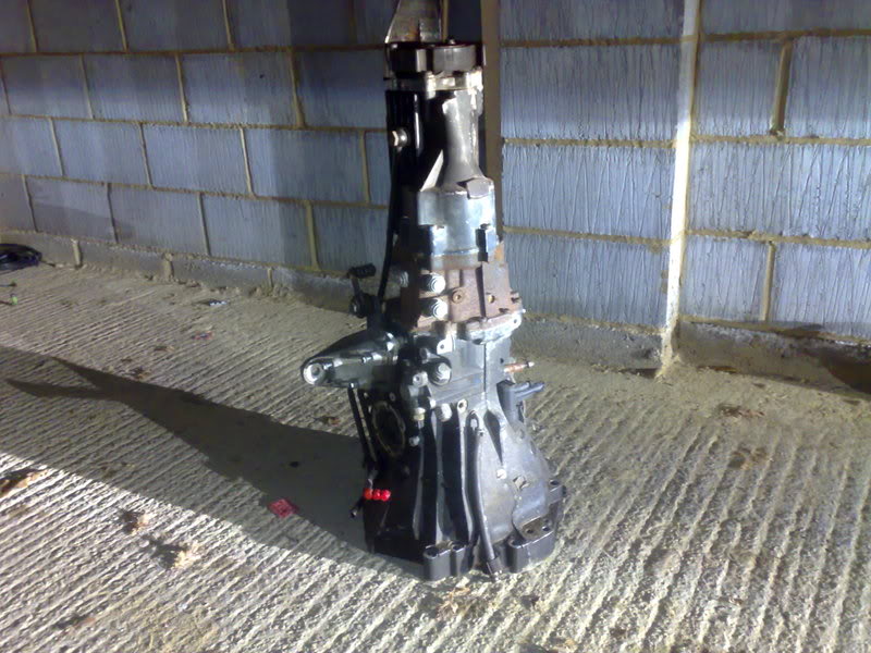

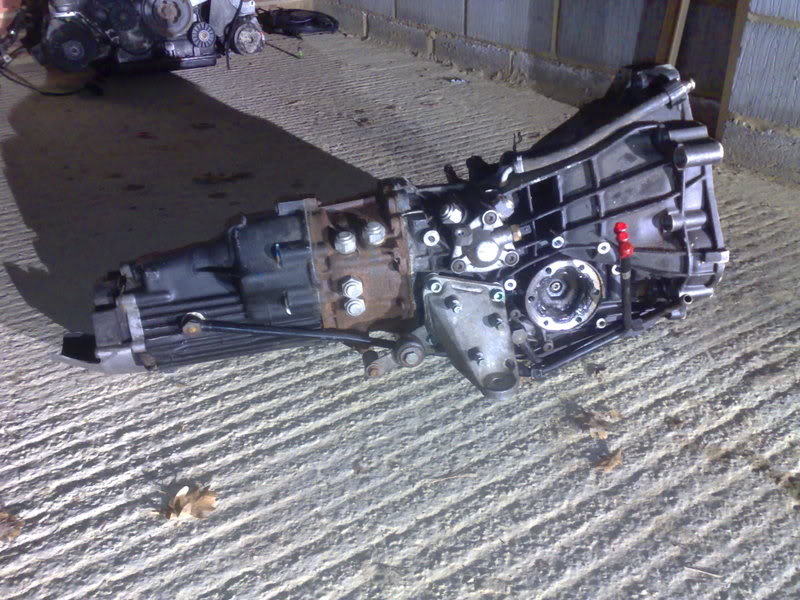

Size:  148.9 KB[/align][/align]6 speed gearbox trial fitted, to determine timing reference... [/align][/align]Name:  14062008645.jpg
Size:  114.2 KB[/align]Name:  14062008646.jpg
Size:  148.2 KB[/align]Name:  14062008647.jpg

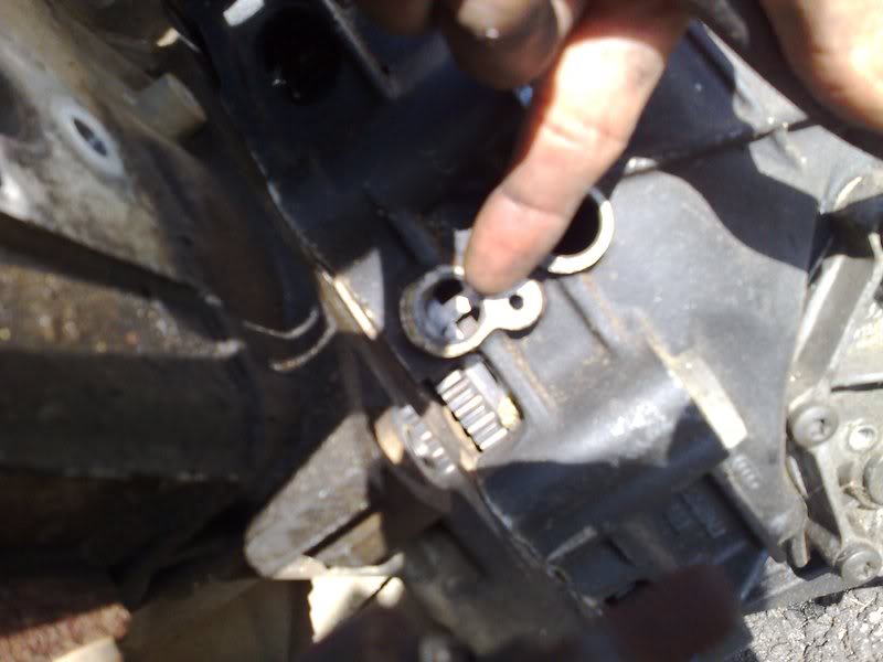

[/align]Timing sensor location...
[/align]Name:  14062008649.jpg
Size:  48.1 KB[/align][/align]Engine's on TDC, in theory the 2 missing teeth should be close by. But, it would appear the 60-2 teeth location is different between auto and manual cars.
Each tooth is 6 degrees. The sensor location on the transmission is 11 teeth before the timing reference. The orange paint denotes the sensor location with the transmission removed.
So, the EMS will be mapped to recognise the settings...
[/align]Name:  14062008653.jpg
Size:  116.0 KB[/align]Name:  14062008651.jpg
Size:  75.9 KB[/align]Name:  14062008652.jpg
Size:  105.7 KB[/align]
