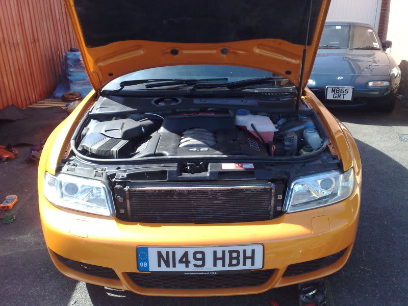

Current status?
S8 motor and 6-speed tranny conversion all done. A blast to drive - had her first mini shakedown at the airfield where my shop is.
Still doing minor mapping, and bug delete. Still need to change the plug on the reverse lamp connector, as the 6-speed switch is different. And connect up the oil pressure and temp switches - again, just need to extend the wires to the original connector on the firewall.

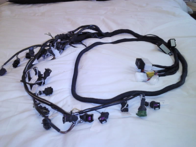

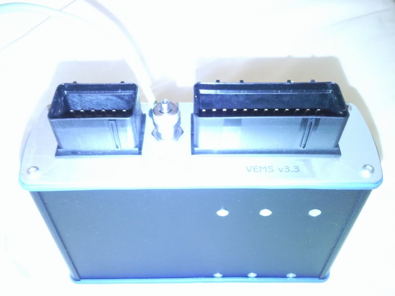

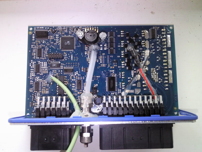

I opted to run the engine on VEMS stand alone...
VEMS v3.3...
Modified S8 harness...

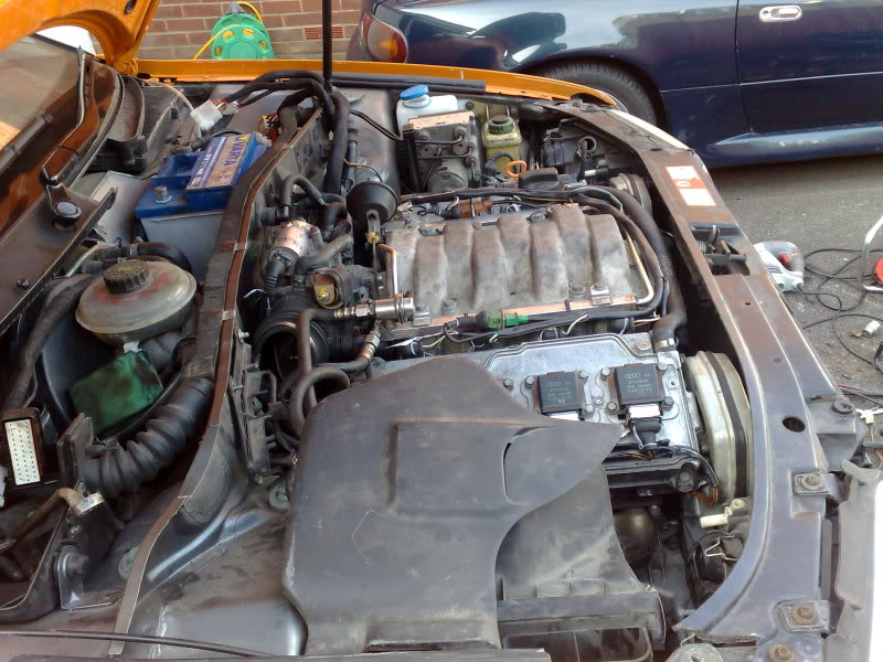

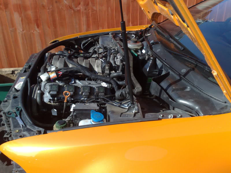

I purchased a cheap B5 front track for R&D purposes...

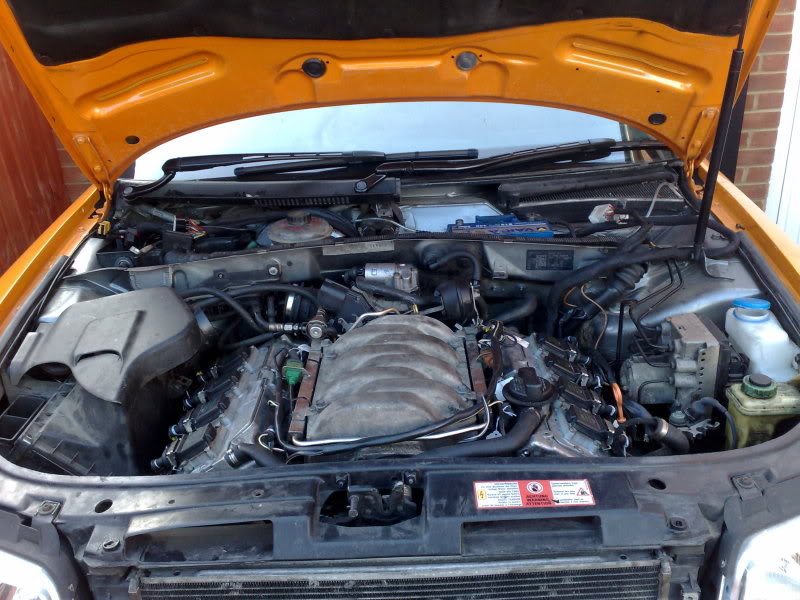

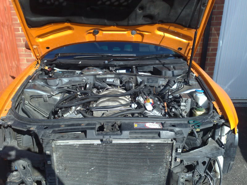

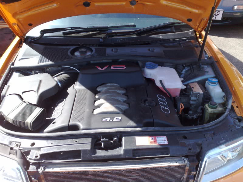

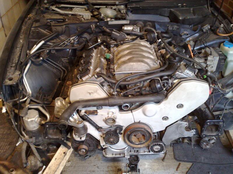

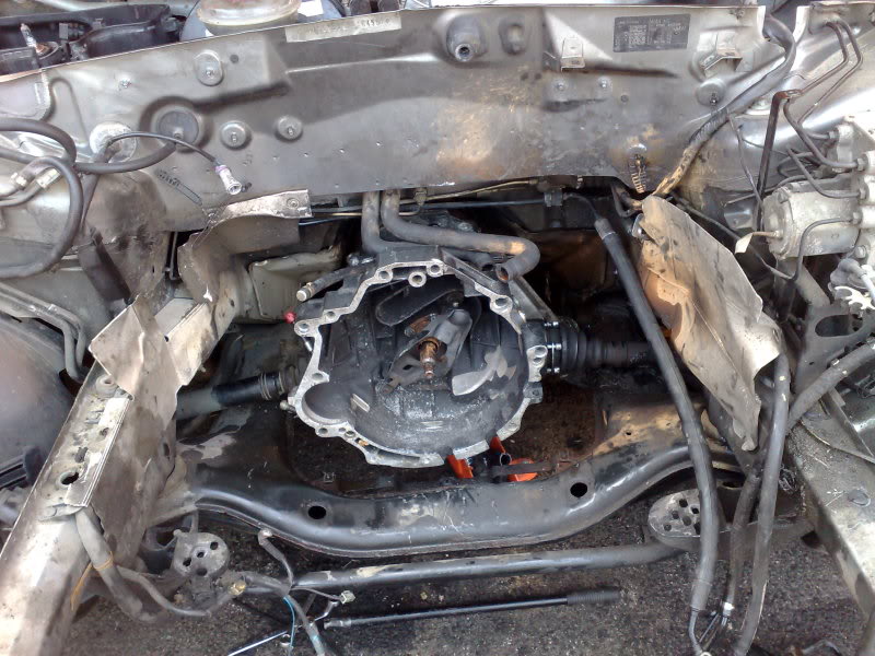

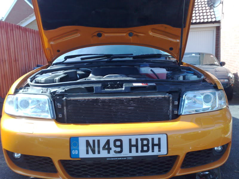

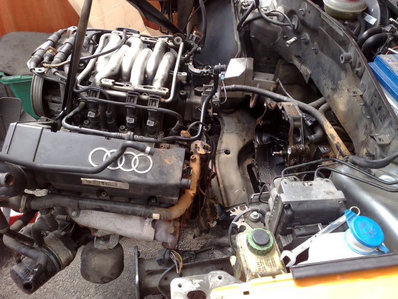

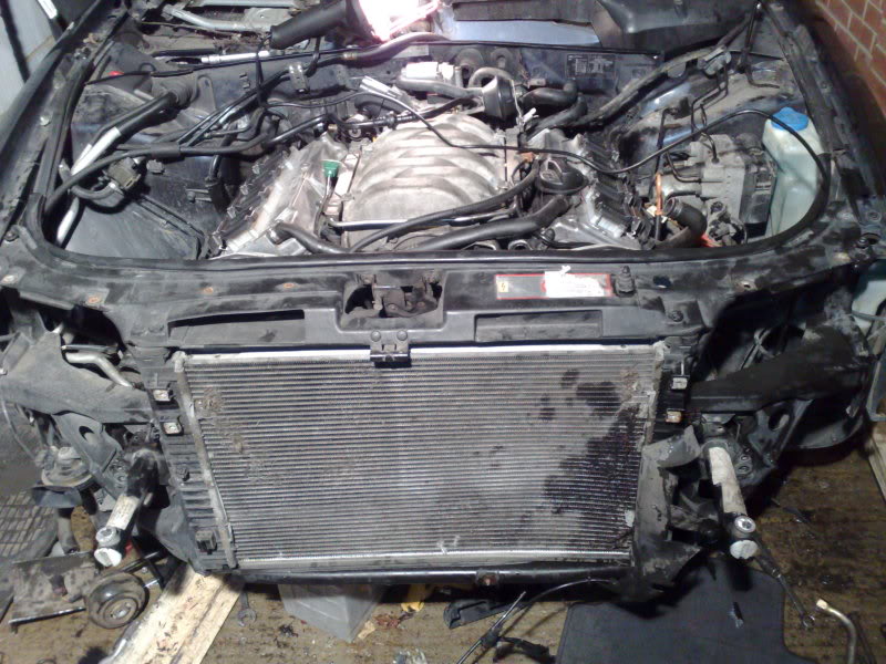

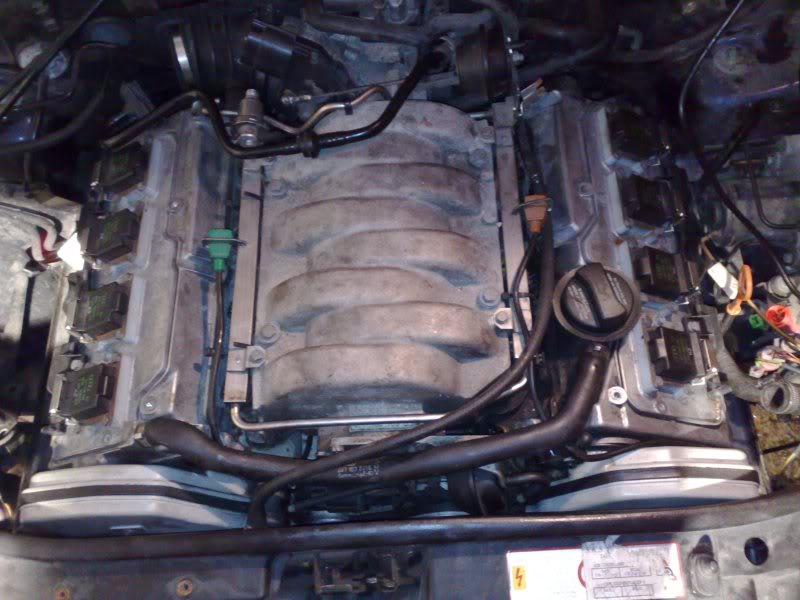

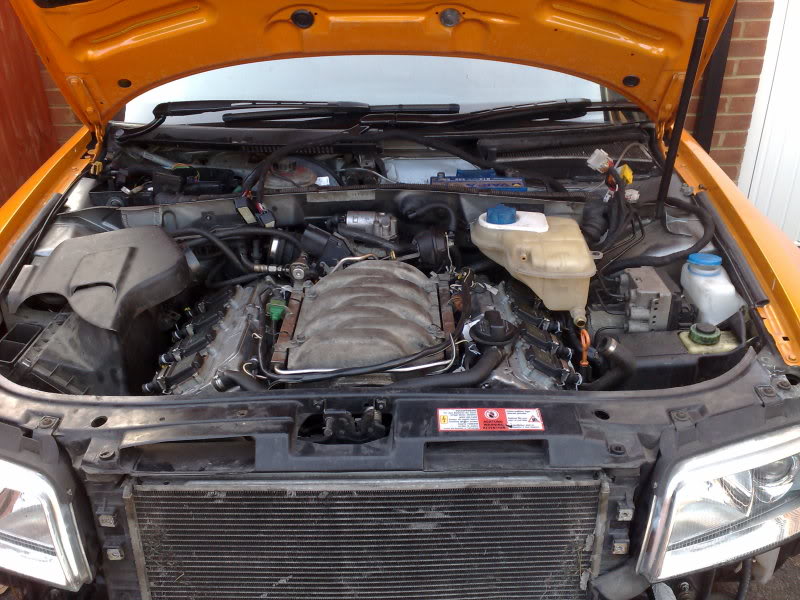

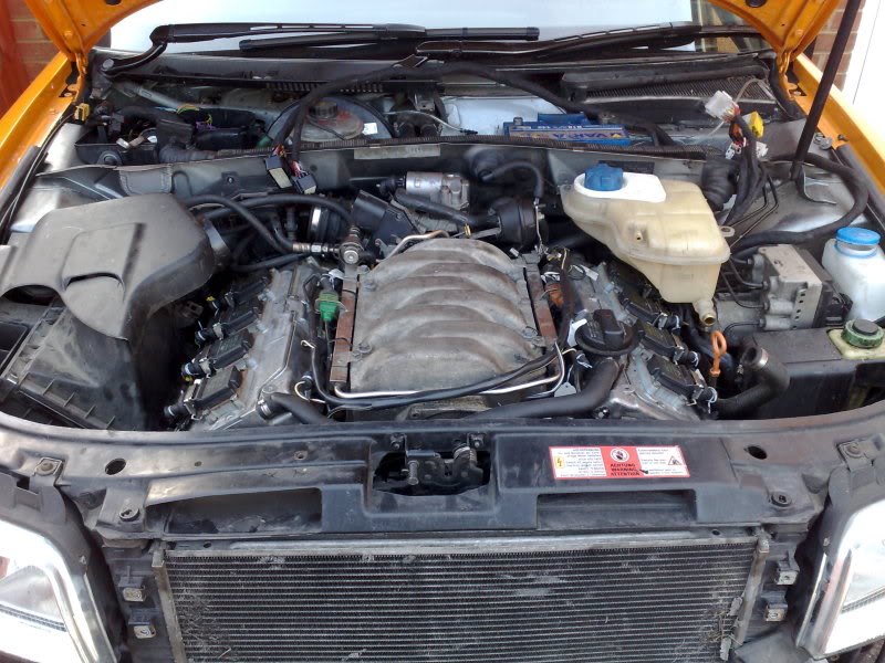

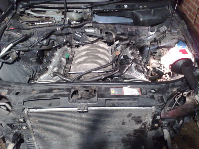

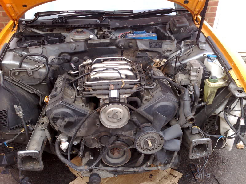

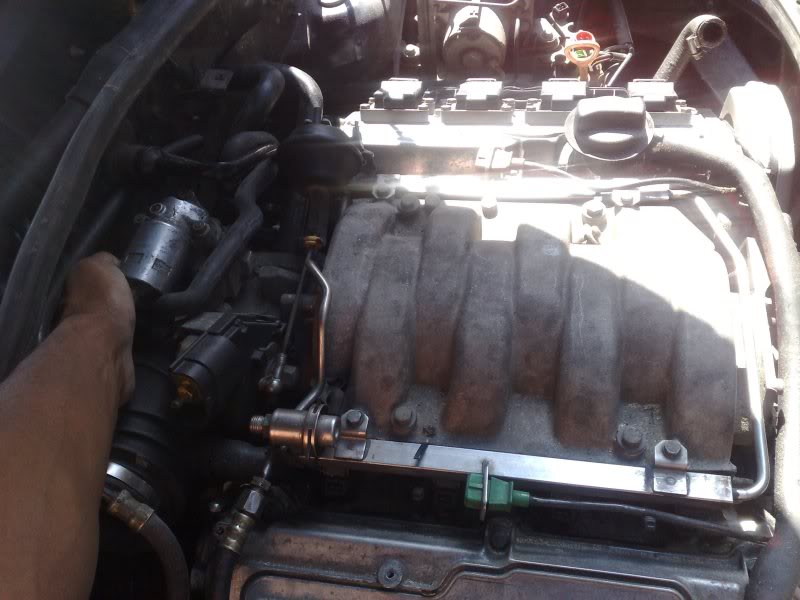

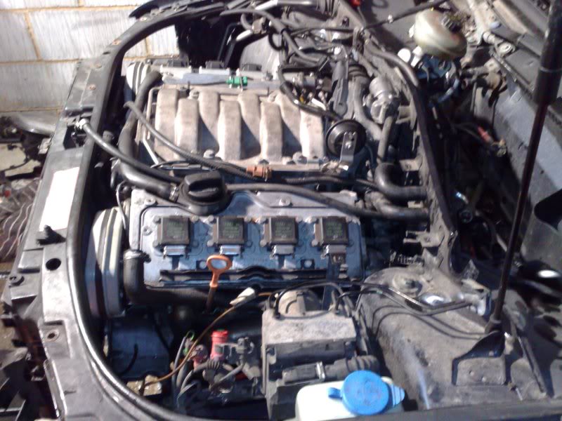

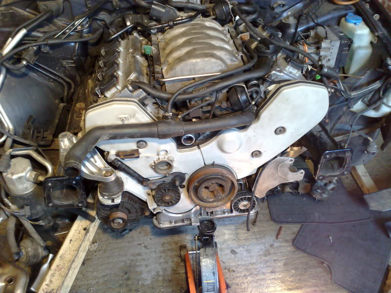

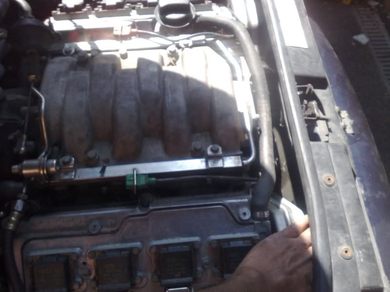

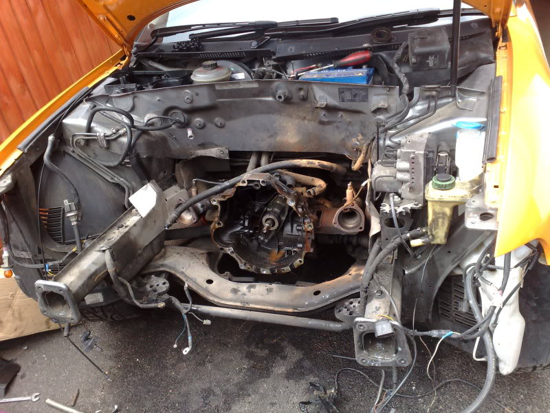

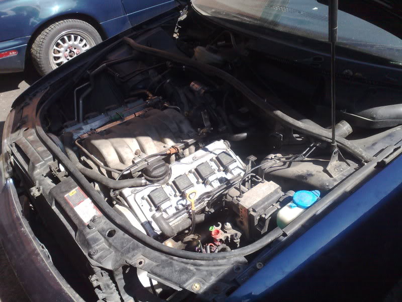

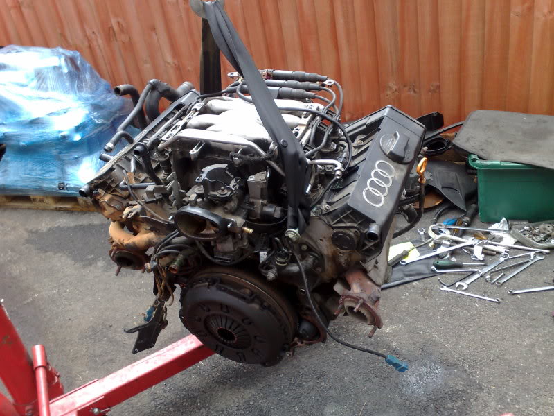

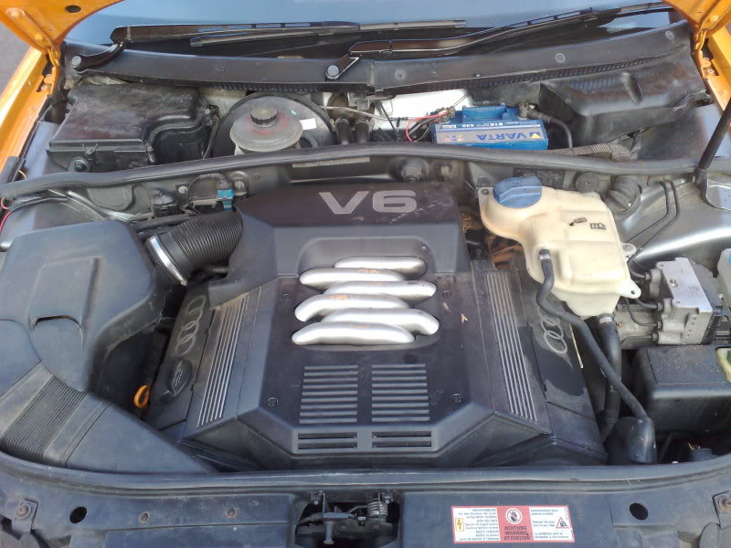

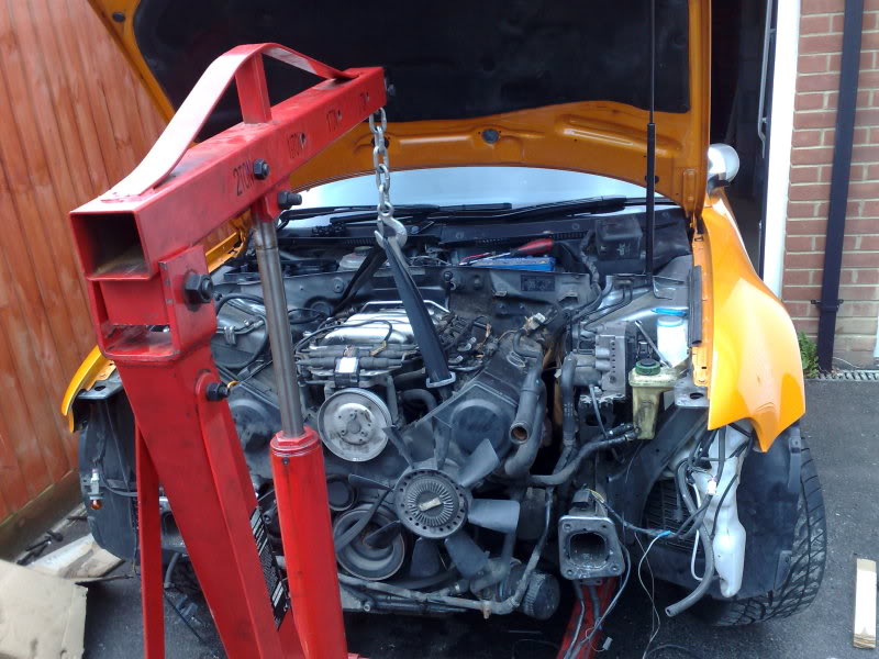

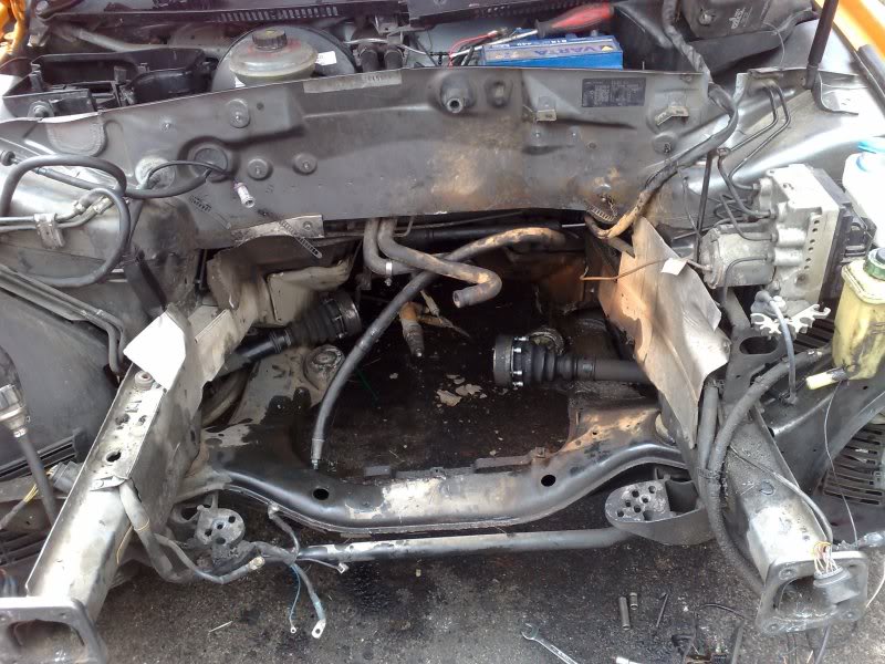

The teardown begins...mileage on my ageing 2,6 V6 12V was 220,000.
Last picture of Outlaw with her old heart...
Teardown...

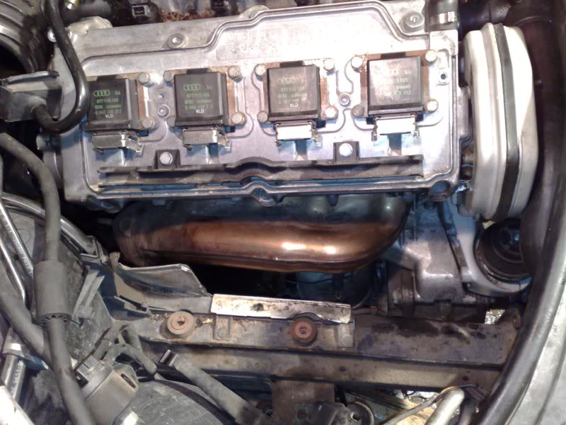

01E 6-speed tranny installed...

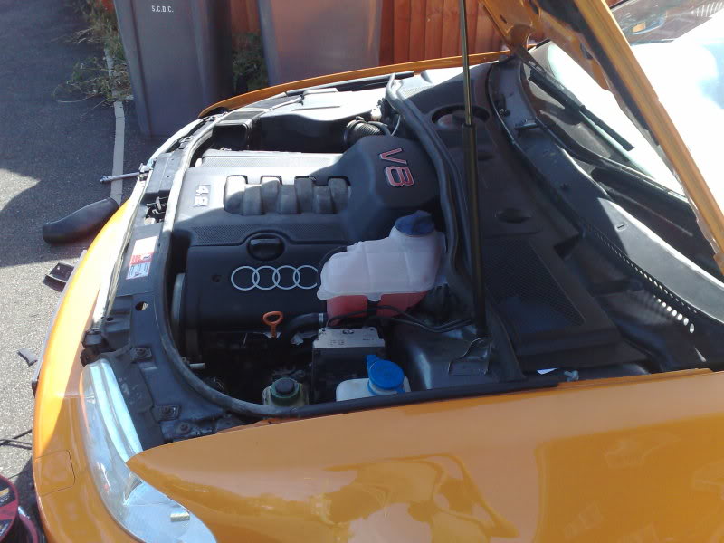

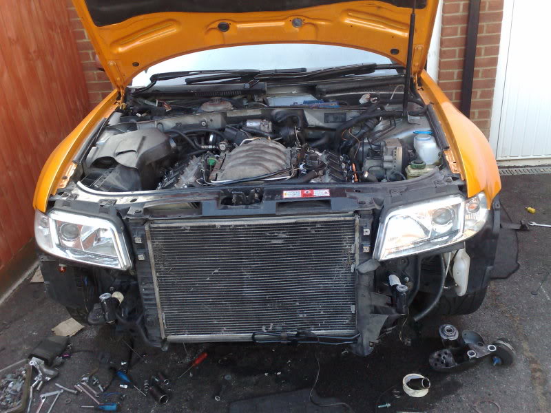

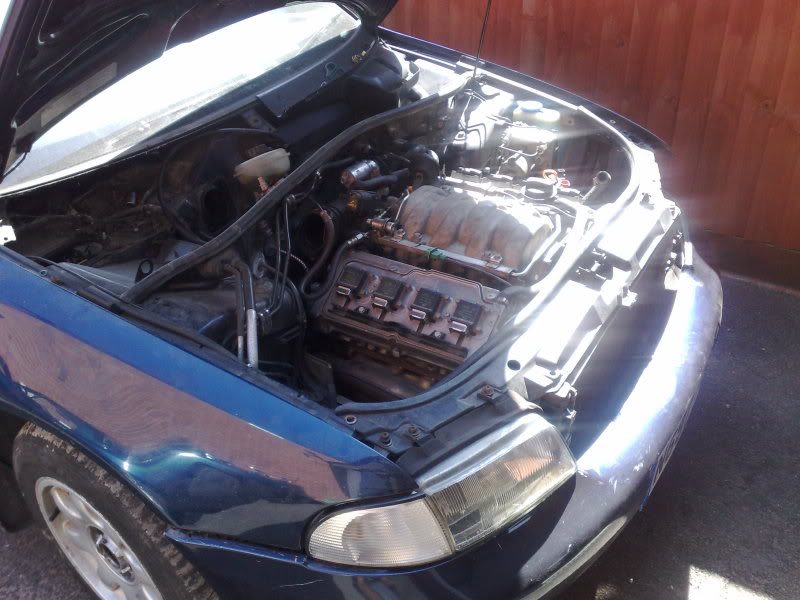

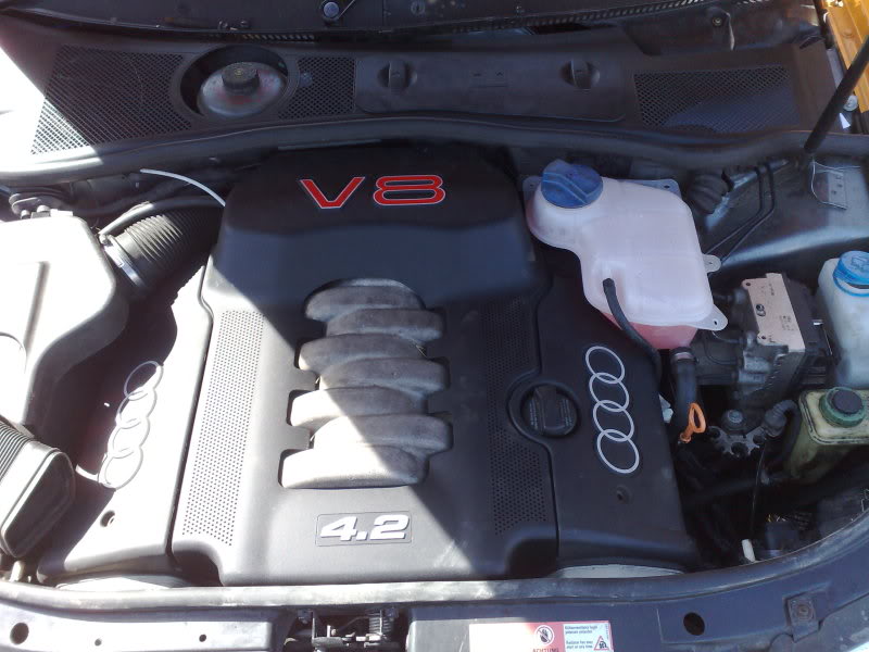

Followed by the mighty S8 motor...

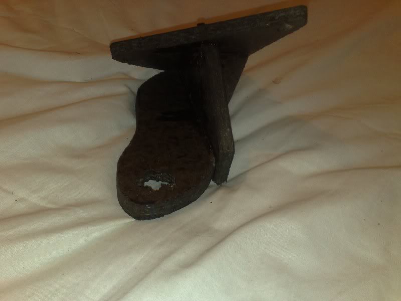

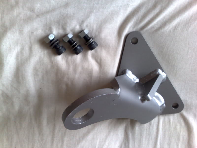

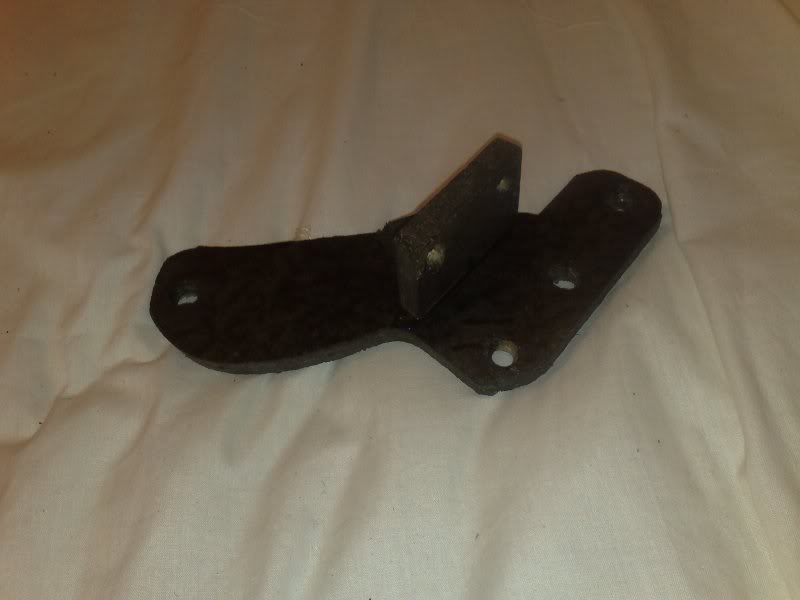

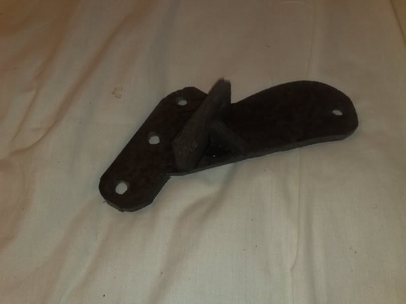

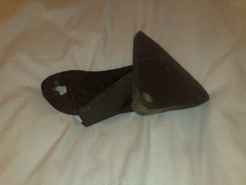

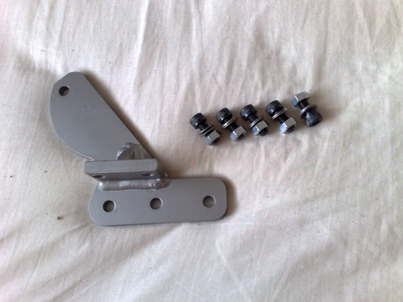

The mounts...

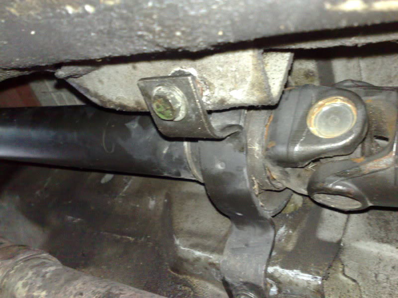

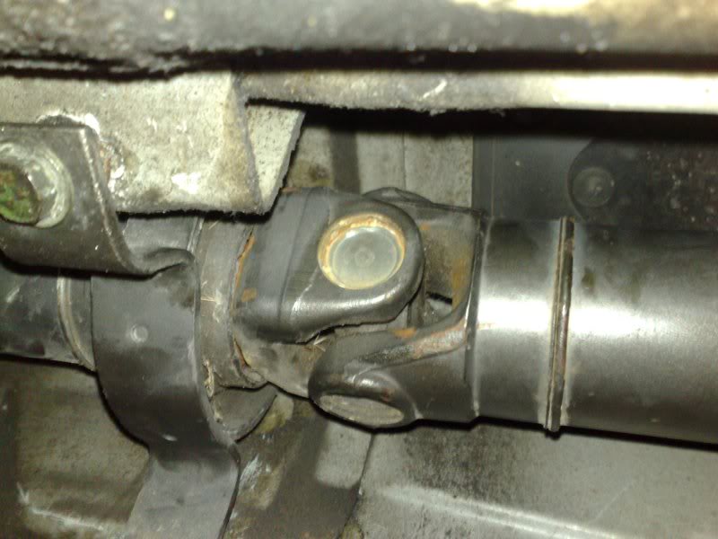

RS4 propshaft...
Voila!
