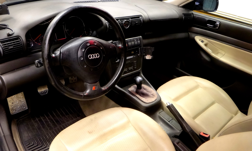

For the boost gauge, AWE center vent gauge or bust. Looks the most OEM imo.
AWE Tuning Vent Mounted Boost Gauge Kit | AWE Tuning
Blends right into the interior.
