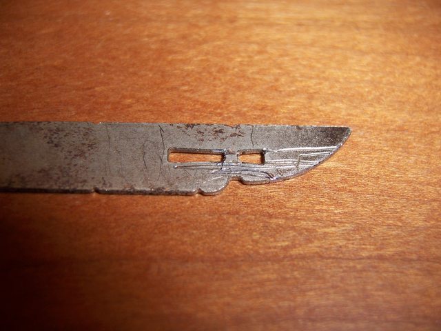

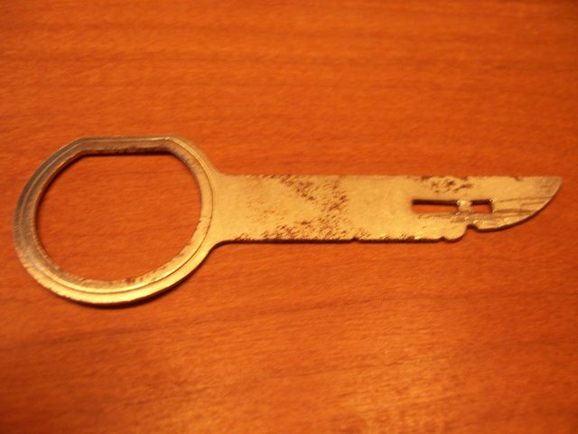

They all clicked and I can't get them out. The right side feels like it might be free but the left won't budge at all. I have tried pulling them out to the point that I feel I'm going to break the key. I have a feeling the top left key is the problem as it feels different when i move it around like its not engaged properly but it still won't come out.

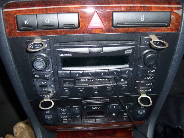

Update: I really yanked on the thing and the top right key ended up coming out. Before I get it stuck again I would like some advice. Do you think it wasn't working because it was inserted improperly? It has some major scratches on it now that seem strange.

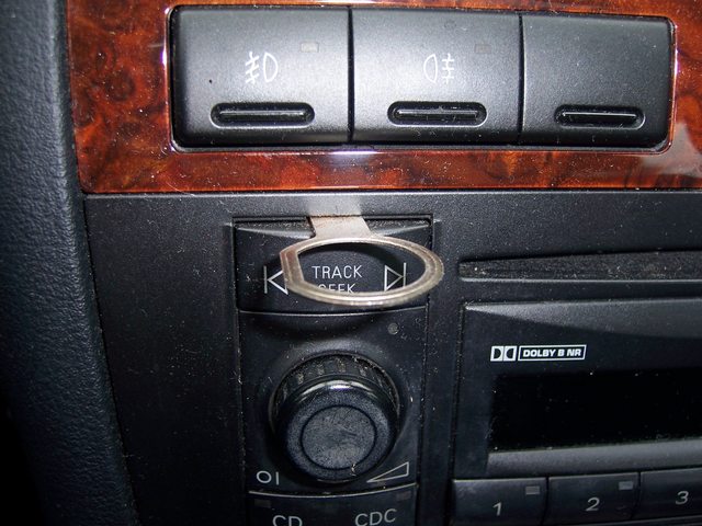

wellll in that top picture you have it wrong... look at the top right one... all of the other flat spots are faced toward the outside of the car, while the top right one is faced in toward the radio...

That picture does show the top right key in backwards(oops) but I've put it in the correct way also and still couldn't get the radio out. For some reason that top right key seems to come out with a stiff pull even after it clicks in. None of the others will do that.
