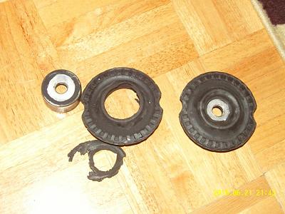

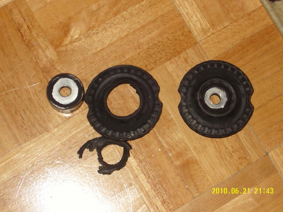

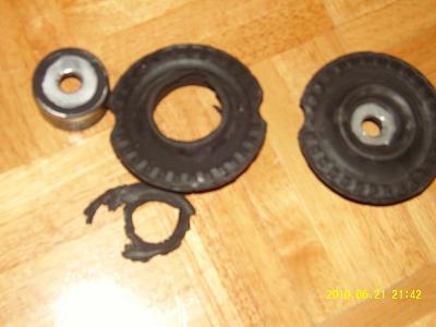

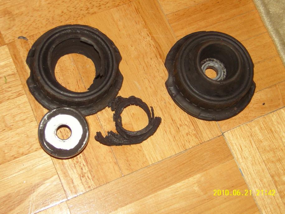

Ok guys here it is! the thumping clunking noise in my front drivers side was a bad strut mount!
So if you checked all your control arms, link bushings, calipers and breaks and you are still getting the clunking noise from the suspension area, then check your strut mounts!! This is the proof that it can go bad!!!! look it is this bad!!! The nut from the top housing of the strut/coil over was banging on the car body every time I hit a bump...
On the left is the bad strut mount (drivers side where the clunking noise was) and on the right is the strut mount from the front passenger side, as you see it still looks good but you know the rule with pairs, you replace them both. I had the dealer install them for $362.00

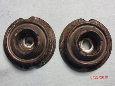

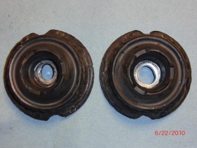

Just replaced my upper strut mount bushings, too, and they were shot. The annoying rattle/clunk is mostly gone on my front end, it seems. I think I'm still getting a little rattle from the upper CA BJ's.
You can see how hogged out the holes are:
