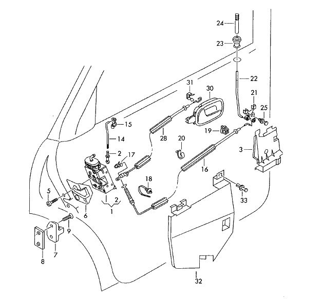

The cable #28 or the clips that hold it on are probably at fault. Here is a picture to show you how it should look when you get in there.

Thanks for all of your help tho, ended up being where the cable clips on to #31 on the diagram you put up, it was not in the clip thus when i pulled on the handle the whole thing moved and not just the wire inside alone to pull on the latch.
