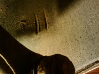

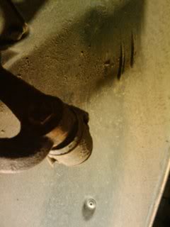

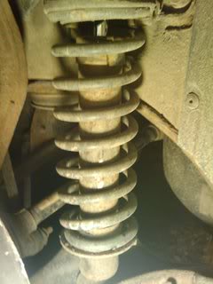

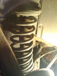

ok i finally got around to taking some pix. it doesn't look good. the passenger side spring is broken along with the driver's side. both sides have the same scrape markings but the passenger side is much sever. the passenger side's broken spring is also rubbing the strut.
here are the pix of the passenger side.

Old Jan 6, 2009 | 03:50 PM
auditech79's Avatar
Site Moderator
Joined: Feb 2007
Posts: 9,004
From: Nor Cal
Time to put in some drop springs
