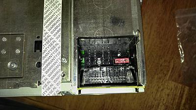

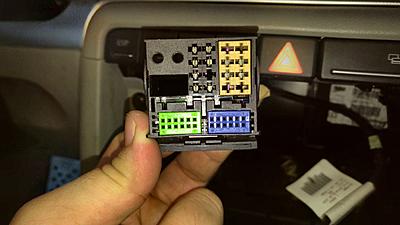

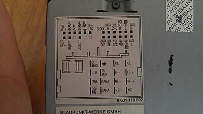

Hello, I upgraded my oem deck to a hyzpo ( nav android etc..) everything fine until I notice no sound on the rear speakers ( I have a non bose with factory amp and subwoofer) so... I start reading ( A LOT!!) and found that I have to connect the RCA from the Radio to the REAR Line in ( the radio comes with the harness) so now I got sound! great! but it is too low... so I keep reading and found that I have to connect the remote power for the factory amp, on this thread it mentioned that it is the white cable to the blue wire on the deck, so I tested checked the voltages etc. but the factory amp is not turning on... I checked the factory radio put the fader to the back and that works perfect. now the questions are
1) where is the factory amp located ( this is on the trunk passenger side OR inside the rear door on the drivers side??)
2) are we really sure that the amp is turned on by a remote +12v signal and not by some can-bus magic?
Here are some photos of the connectors I have

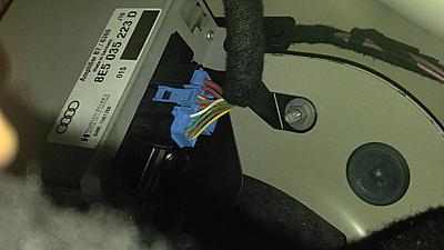

Actually that is not true on my Audi A4 2007 By 2.0 it is on the passenger side inside the carpet cover. like beside the fuel door but inside.
So back to the topic in my case I tested and the white wire is connected to the amp and actually powering it, but I got low volumne, so just connected the rear speakers to the amp, and play with the fader on the head unit. I got nice decent volumne. and good quality too
