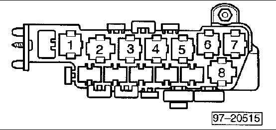

Whats up guy Im new to the audi world and need some help..
I have a 98 audi 2.8 qauttro 5sp and need a picture of the relay wiring under the driver dash
bought the car as a project and been searching for a while and all seem to find is pictures of the 1.8t and don't seem to be the same

Nope for the B5 it would go something like this
1 - Coolant Fan Control (FC) Relay (214) (a)
2 - Solar Cell Separation Relay
2 - Relay For Motor Remote Unlock Rear Lid (79)
3 - A/C Clutch Relay (267)
3 - A/C Cut-Off Control Module (384)
4 - A/C Cut-Off Control Module (384)
5 - Daytime Running Lights Change-Over Relay (173)
6 - Selector Lever Light Relay (205)
7 - Fog Light Relay (381)
7 - J9 - Rear Window Defogger Relay (381)
8 - Daytime Running Lights Change-Over Relay (173)
8 - Control Unit Multifunction Steering Wheel (450)
9 - Control Unit Multifunction Steering Wheel (450)
10 - Brake Booster Relay (373) (569)
10 - Lamp Failure Control Module (373)
12 - Starting Interlock Relay (Alarm System) (185) (186)
13 - Starting Interlock Relay (204)
13 - Starting Interlock Relay (Clutch Position) (204)
13 - Starting Interlock Relay (Clutch System) (53)
The bottom half of the relay panel goes
1 - Dual Horn Relay (53)(204)
2 - Load Reduction Relay (213)
3 - Wiper/Washer Intermittent Relay (317)
4 - Fuel Pump (FP) Relay (208) (372)
V - Wiper/Washer Intermittent Relay (377)
VI - Wiper/Washer Intermittent Relay (377)
Eightfold Auxiliary Relay Panel On the back of the relay panel
1 -
2 - Second Speed Coolant Fan Control (FC) Relay (V7) (b)
3 -
4 - ABS Solenoid Valve Relay (373)
5 - Coolant Fan Control (FC) (214) (c)
5 - First Speed Coolant Fan Control (FC) Relay (214) (d)
5 - First Speed Engine Coolant (EC) Fan Control (FC) Relay (214) (V7, V35) (e)
6 -
7 - ABS Return Flow Pump Relay (373)
8 - Secont Speed Coolant Fan Control (FC) Relay (213) (f)
**Notes**
(a)Applies only to the following engines:
- 1.8L (AEB/AUG/ATW)
- 1.8L (AWM with Manual A/C Control)
- 2.8L (AHA with Manual A/C Control)
- 2.8L (ATQ with manual A/C Control) (M/Y from 10/00)
(b) Applies only to the following engines:
- 1.8L AWM
- 2.0L Diesel BHW
(c) Applies to vehicles with 80W coolant fan
(d) Applies only to the following Engines:
- 1.8L AEB/AUG/ATW
- 2.8L AHA with Manual A/C Control
- 2.8L AHA with Climatronic (M/Y through 7/98)
(e) Applies only to the following Engines:
- 1.8L AWM
- 2.0L Diesel BHW
(f) Applies only to the following Engines:
- 1.8L AEB/AUG/ATW
Does it look right?
