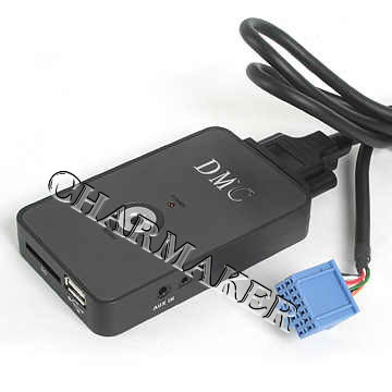

When I first purchased my car, I was in the same dilemma and after some searching and research, I ended up buying a virtual digital CD player. Here is the link and a picture.
Charmlink Ipod interface,Ipod integration,USB/SD Interface,Digital Music Changer
It works in the structure of a 6 CD changer with 99 songs per cd/directory via a usb stick or sd card. You can fast forward and skip ahead using the OEM head unit. Mind you mine is a Symphony and I don't know if the Concert has the same functions. You will have to figure that out. The only function that I wish it had was Shuffle which doesn't seem to work. This is all done through the CD port in the back of the head unit. It also has a 1/8 inch input that you can hook your MP3 player too if need be but controls are through the MP3 player itself and not through the head unit. This is essentially the same thing as the Yatour that you have posted above. Mine has been working great for the past 4 years. Hope that helps.

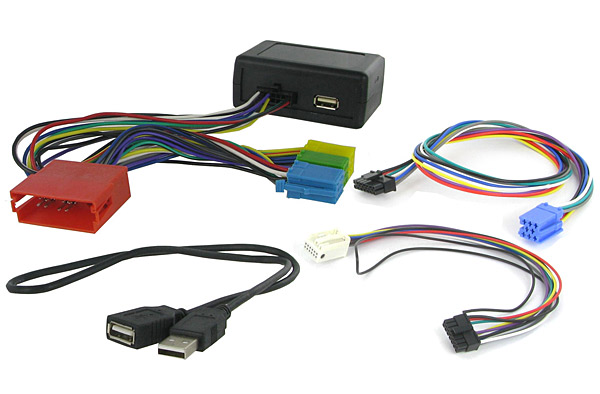

I did find this on ebay .... sold from the UK - anyone tried it?
Audi A2 A3 A4 A6 A8 TT USB Adapter Interface CTAVAGUSB001 CTAVAGUSB003 Car MP3 | eBay

If you click on VW, it lists Audi compatibility there. I would chat with them when they are on-line and they can help you out there. That's what I did before I purchased.
The unit you listed is essentially the same thing but it looks like it has random and is cheaper than the unit I bought. Trust me with 99 songs in a directory with no way of sorting, random is nice to have.

Jason from In Car Connections contacted me to confirm that their USB unit will shuffle mp3 files by pressing the RAND button on the Concert radio.
Details can be found on their website
In Car Connections - In car AUX adapters iPod interfaces Car speakers Car radio stereo - In Car Connections
The USB changer units are listed here
USB Adapter Interfaces for factory fitted car radios - In Car Connections
Please note that this unit does not provide a 3.5mm aux in
