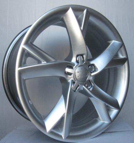

Yes I know another rims thread. Ok we'll looking to order some rims for the 00 b5 1.8tqm I'm lookin at some replica rims I can get threw my work I'm going 17in with 225/45/17s there a few choice but there's one set idk what it comes from and if it will fit it's a 17x7 with a 45 offset will this work the other set is a 35 offset I know that will work and there is a 40 offset I dunno if will fit either but I want to be able to run without spacers what do you think

I run 17x7.5 et35 with 225/45/17. If your pretty low, you'll need the front fenders rolled. I'm moderately low (~2" drop) and my front fenders are NOT rolled, but every once in a while I hear a tire scrape. It's no big deal.

It's gunna have stock springs and Blau struts no lowering no thank you lol

17x7s with a 45offset with 225/45/17s with stock springs and Blaustruts which are the same height as oem

What's the question? Will it work? Yes, it will. The S4 came with 17x7.5 ET45 and 225/45/17.

So that should fit with no rubbing and no spacers needed? Cause I'll never use spacers

No I saw that you said it will fit I just wanna make sure it will without spacers

The S4 doesn't come with spacers, and your suspension (minus springs and shocks) is the nearly the same as a S4. Therefore yes, it should fit without spacers.
