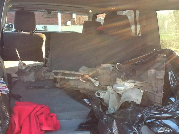

So I bought a trans

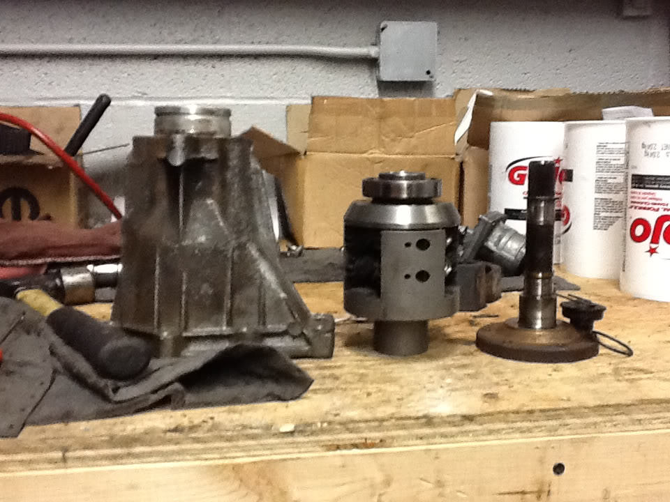

And started by pulling the Torsen off. Name:  4f58e2ac.jpg

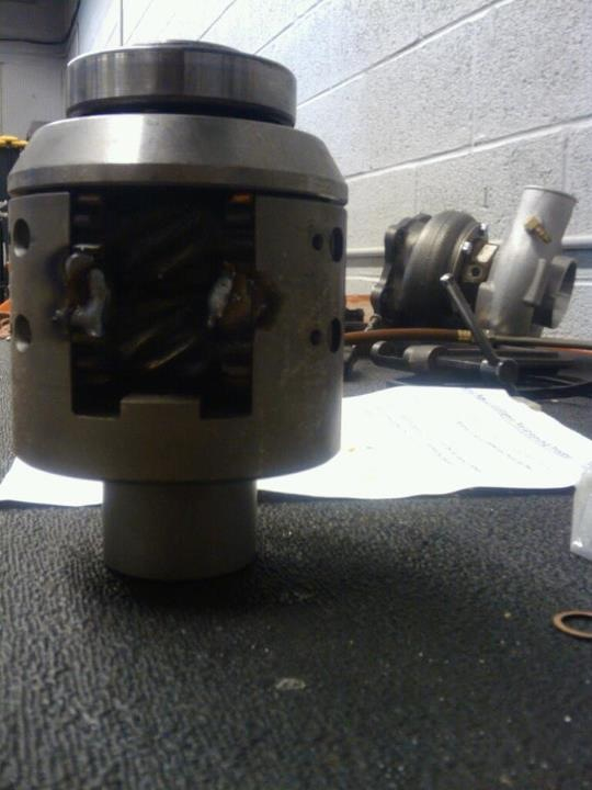

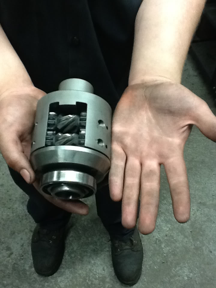

That little c clip is all that holds the Torsen in the housing. Mind you the Torsen is only this bigName:  c84a18d2.jpg
But I welded it up niceName:  03e40917.jpg
And reinstalled. Took about 5 hours to do the trans swap. I also swapped shift box to one with fresh bushings and shortened linkage.

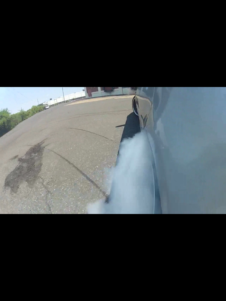

I've put about 100 miles one the car all slightly sideways. Name:  3f218b88.jpg
And did some donuts here is videoName:  th_c0bc9f7c.jpg
will keep thread updated with pictures and video. She is fun hp wise I'm somewhere around 330-350 range depending on heat soak. Today is suppose to be 103 in Pennsylvania so she will stay parked.

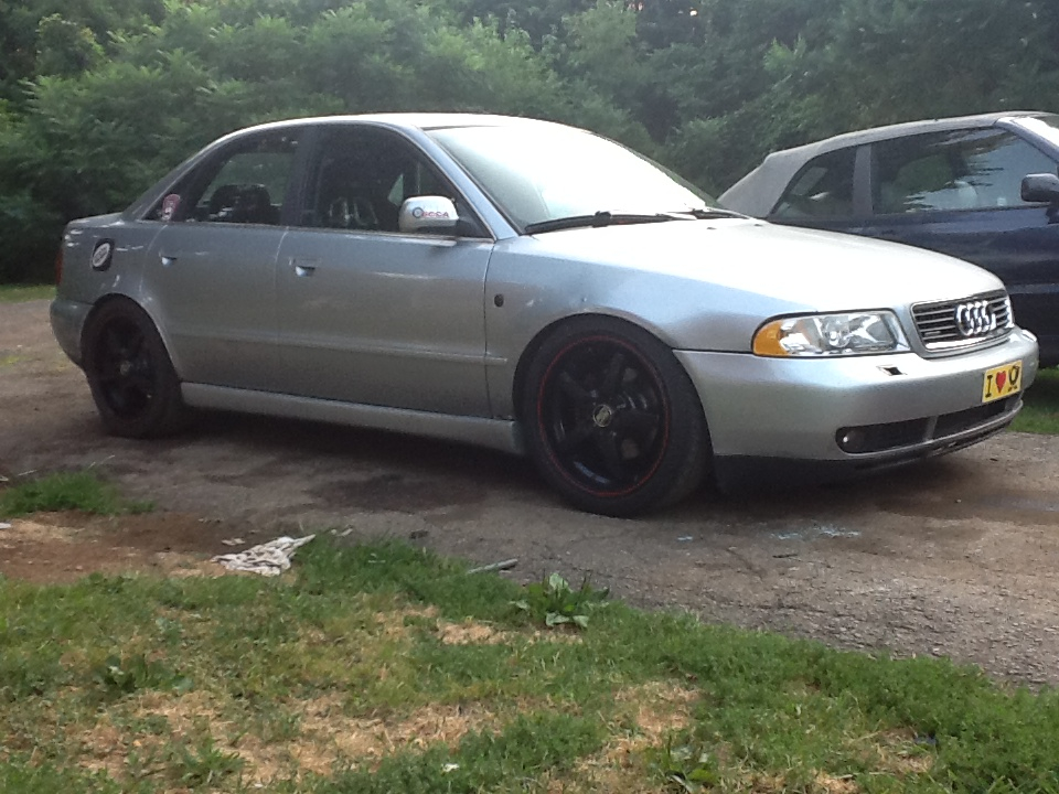

Yesterday I traded my Asa 17s for a set of msw 18s with 235/40/18s. Car feels great with the extra rubber under it. But I need smaller tires for the front. She rubs, I mean I knew she would but was still hoping.
Jeremy when is summer meet this year. And the vw won't be back together so I might take this to waterfest.
Old Jul 18, 2012 | 06:53 AM
ImTheDevil's Avatar
Joined: Jul 2006
Posts: 11,670
From: Binghamton, NY
I had 235-35-19s a couple years ago on ET42 wheels and was able to clear the uprights by using 5mm spacers - maybe that'd work for you too. Still waiting for Bill to confirm wih the park for a weekend on the meet - hopefully I'll have info soon.
Old Jul 18, 2012 | 06:55 AM
b5blazing's Avatar
Posts: 144
From: N.E. Pa
New wheels not really a fan just needed a change. They looked like a million bucks on black s4. Look eeehhhh on my silver
