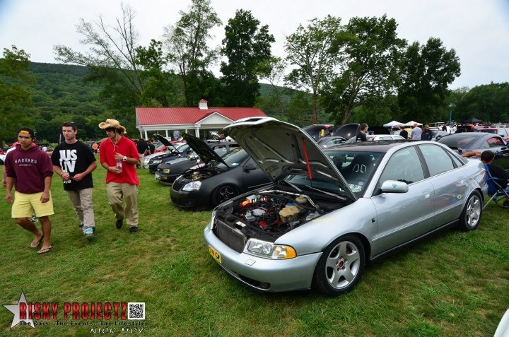

From: N.E. Pa
Sorry for long update but I have been busy.
Been around been braking car parts and driving hard.
Replaced passanger cam tensioner this past week. Was checking oil seal behind cam position sensor and I broke the reading tab off cps.
So I'm waiting for a cps I'm hoping to have car squared away for this weekend. Last race of the season, and I'm dying to go slide around and beat the subies and evos.
Just hoping parts get here. Maybe I'll just trailor car down and run with out my cps if its not here by Friday.
Don't wanna hurt car but I need to get this out of my system before snow hits.
