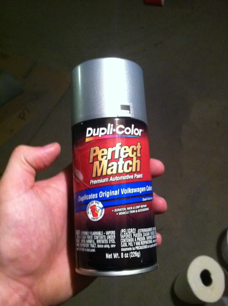

Progress: Name:  5e15a01b.jpg
Size:  99.3 KB primered and sanded. Next comes this: Name:  619d8bf0.jpg
Size:  92.2 KB hopefully its a close match.

Is that Brilliant Silver? I think the can says matches Chrysler paint.

It says volkswagon because they dont have any audi there. Itll look better either way. Its volkswagon silver. Types of silvers known to match like "Radiant silver" also werent there. They only had these perfect match types and high temp type paint. I went to two diffetent advance autos. Lets hope its a close match.

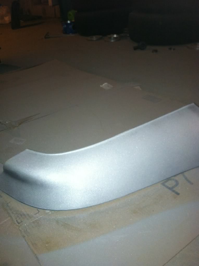

After a few coats without flash closeup : Name:  0e528cc9.jpg
Size:  122.5 KB with flash: Name:  224f232d.jpg
Size:  41.8 KB not the best pictures because its really dark in my basement with poor lighting and its midnight. Will post more after clear coat and then on car xD.

Duplicolor makes Brilliant silver now, it replaced radiant silver I believe. I think the volkswagen silver is lighter.
The right one will say matches Chrysler colors.

Well I can just wetsand it a bit and paint the chrysler one over it right?

did you get the VW Reflex SilveR? Ly7a i think it is? thats the only vw color they had where I'm at. I don't think it is even close to matching

The color to buy is Bcc0338 Radiant/brilliant silver met (ca1, Pa1) replaces DSC338/t347.

Ok ill buy some of that. Yes the one I have is reflex silver . I wetsanded it. Should I primer it and then put the right silver or should I just paint right over?
