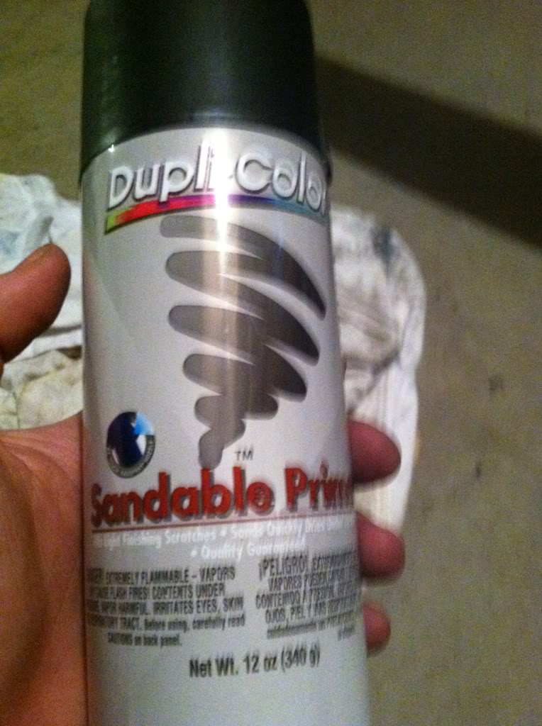

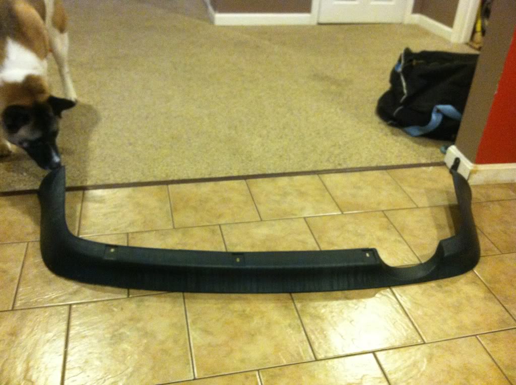

Sorry to res this but its finally happening. Ok here it is. I just took it off my car. Name:  bcb90287.jpg
Size:  111.4 KB can I use this primer? Name:  40120cdf.jpg
Size:  119.3 KB what is fuller primer?

I got two cans of silver, two clear coats, and 1 adhesion promoter along with primer pictured above. Do i have to sand before adhesion coat or just clean first?
Clean it up nicely.. No point in sanding it before, it's textured so I don't think it'll do much good.
Spray the adhesion promotor, sand, filler primer, it helps to fill the textured parts better, sand, then go from there.
Follow the DIY that's floating around the forums. I think it's on audidiy.com. If not just google it and you should find it.
